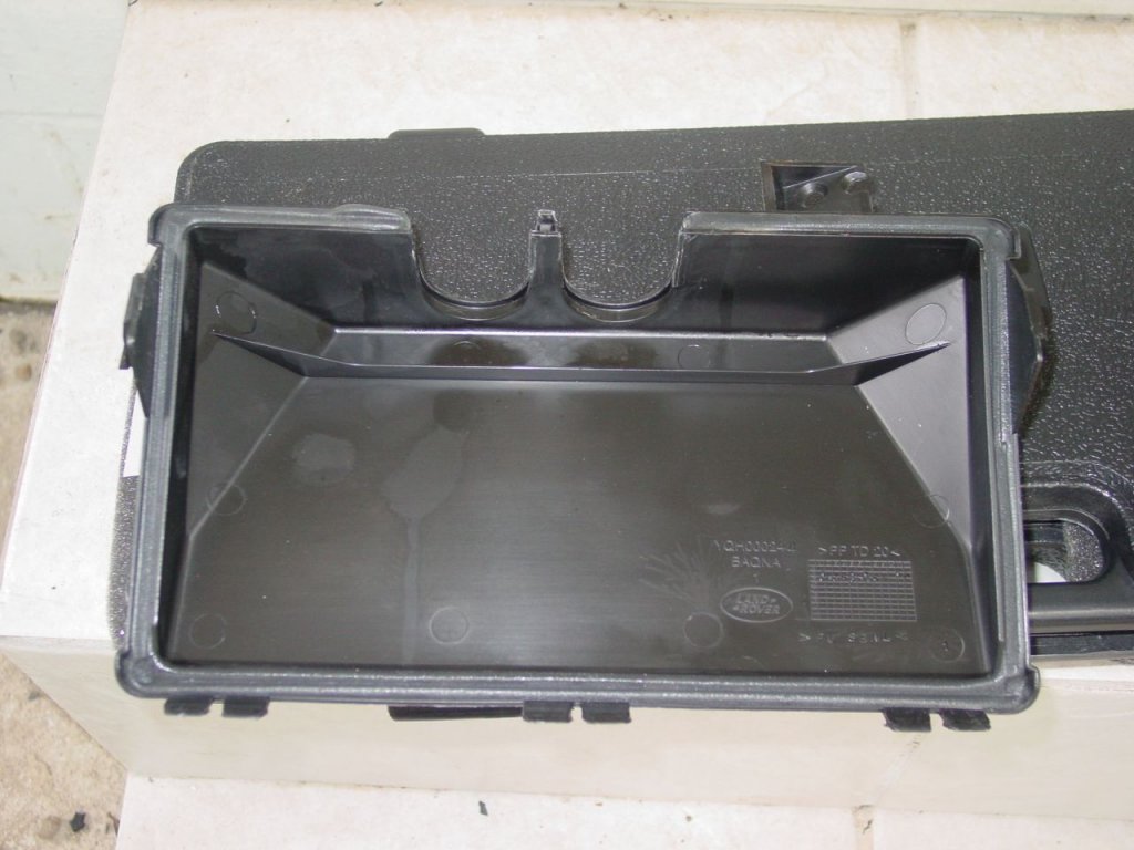

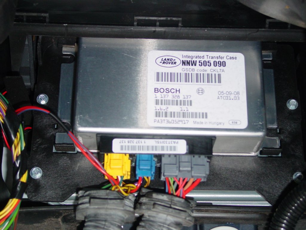

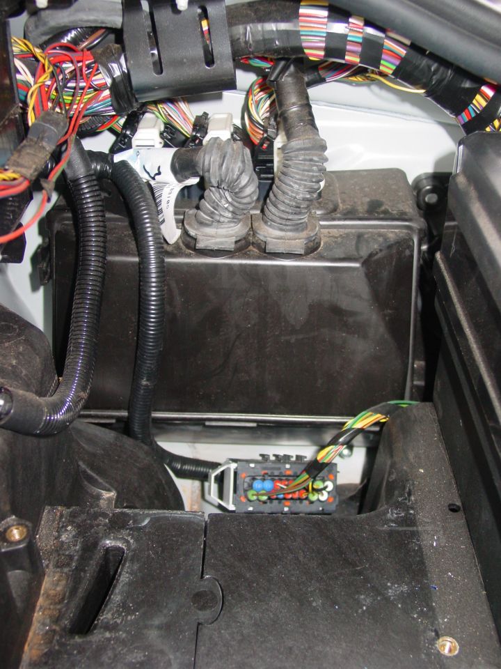

I noted the comment re the Transmission Control Module. Per the jpg's it is located on the firewall behind the engine starting battery. You will note the 3M black electrical tape I have wrapped around the two rubber cable guides. This is to reduce water ingress onto what is effectively a near wide open to the wet, circuit board that relates to the operation of the transmission and transfer case.
The third jpg is upside down so it can be read but not the rubber cable guides sit directly on top of the coloured connectors.
The Transmission Control Module is located in the transmission, it’s part of the valve body mechatronix. The box behind the battery is the Transfer Case Control Module.
