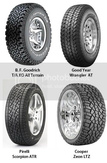

Neither Cooper nor Pirelli do the prospective buyer any favors in terms of information. The descriptions for the tires at the company websites are very vague. If you look at some of the more well respected all terrain tires out there, namely the Good Year Wrangler MT/R and AT and the B.F.Goodrich All Terrain TA/KO and Mud Terrain, there are several traits they have in common.
One is a really tough 3-ply sidewall. This is important when an off-road tire is aired down, because the truck is riding on the sidewall. But even for an LR4 (because, face it, it's a useless gesture to air down a 255/55R19 tire, and maybe even counter productive in that it makes the rim more vulnerable) a tough sidewall is important because it resists cuts and punctures from rocks and branches.
The Wranglers and BFG's also have deep open tread designs and substantial lugs. The lugs of course provide more grip on uneven surfaces, and the open tread is to help the tire shed mud, snow, and dirt that would otherwise build up and stay in the tread, making the tread ineffective.
I have opined before about the benefit of a generous side wall in an off road tire, so I won't beat that horse again.
(By the way, I don't mean to malign other manufacturers by omitting them. But it must be said that Good Year and BFG are the giants upon whose shoulders all the others stand.)
I have no experience with either the Pirellis or the Coopers, and as I said, I couldn't find any information on their websites about how their tires are constructed. So, going just on the picture :hmpf:, I'd point out that the Cooper seems to have a bit more open tread and at least an attempt at a lug, and has a slightly more aggressive look than the Pirelli.
On the other hand, the Pirelli has been around for a while and has lots of fans, while the LTZ is relatively new and has had much less time to develop a track record.
Or - Unless your Conti's are ready to go, you could bide your time with the notion that someone will come out with a tire that's more aggressive than the Cooper.

Hey CaptainSpalding,
Thanks for the thorough response. The B.F. Goodrich and Good Year Wranglers look like awesome tires, but sadly not available for the 19" wheels on the LR4 (255/55/R19). The Pirelli Scorption ATRs and Cooper Zeon LTZs are my only two viable choices. In doing my own research, I think the Coopers are a bit more off-road capable and beefy looking, but I can't find as much information as i can for the Pirelli ATRs.
I can definitely hold off as my stock Contis are in excellent condition and fine for the off-roading I do, but I hate the look. Like I said before, I am not going to do the 18" wheel upgrade until I know I am keeping the truck longer term.
I hope this post keeps going, as it's still a little while before I pull the trigger on tires - so maybe there will be a couple more options! :)
Personally, I love the B.F. Goodrich tires - but I don't know if there are plans to have them in 255/55/R19s.
