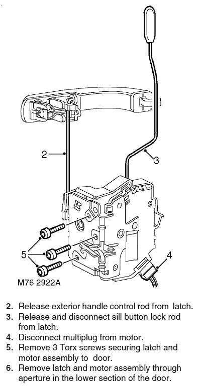

I managed to get the door open and peeled the plastic away but I can't seem to figure out how to get the lock actuator component out of its socket. I removed the screws and it's loose but it doesnt seem like it'll be able to come out due to the size. It seems that the white portion comes off from the black plastic housing which has the 2 wheels that is supposed to turn to unlock the door and open it from the outside. Is that piece the actuator or is it the piece that you look at from the inside? Are these 2 pieces supposed to come apart?

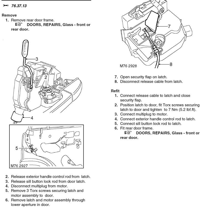

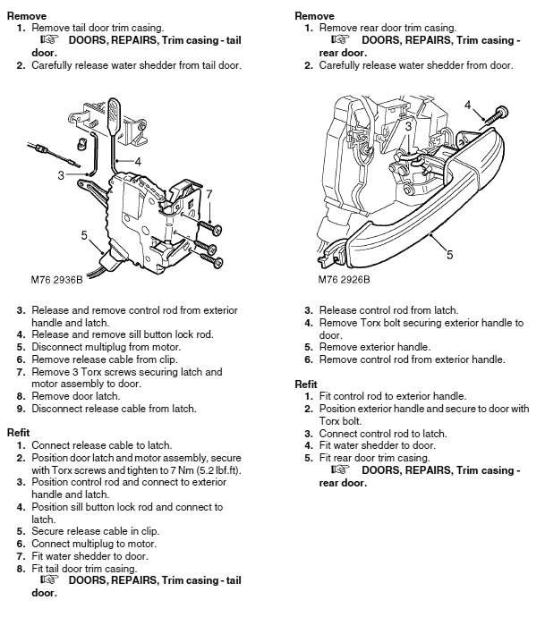

Hope this helps.

Thanks Joey for the quick reply. This seems a little more detailed then what I got from the Rave CD. Appreciate it. Will give it a shot on Saturday.
