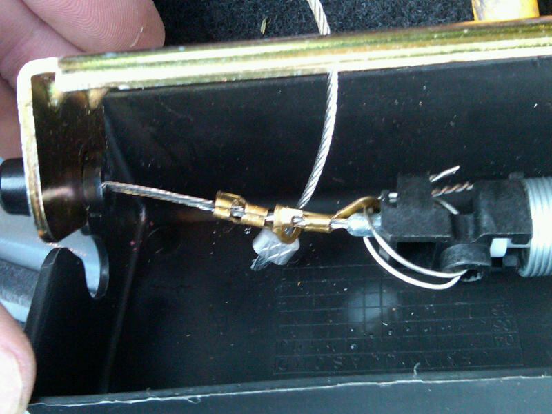

Thanks for all the great info in this post. I took advantage of it today as I repaired the liftgate on my 06 LR3. Once I got the lower hatch open and pulled out the actuator I saw the broken L-angle fall to the group. I took two ring electrical ring terminals and crimped them to the actuator cable inside the box. The first one I double tied to the servo with safety wire and the second I ran 2' for 1/16" braided steal cable through and drilled a hole through my lower liftgate so I now have a manual quick release if this ever happens again.
