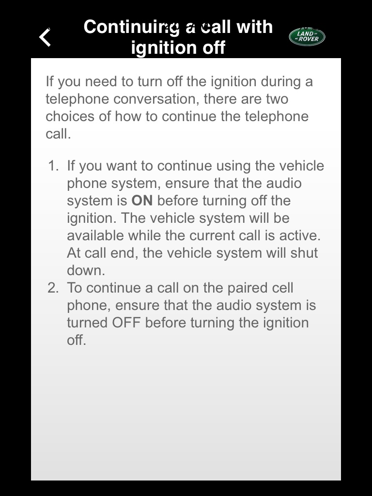

SC_BLACKOUT
Aug 5, 2014
I can talk for about 2 minutes after ignition is turned off (2012 RR SC) this is the setting for a 2012, I couldn't find it for a 2007. Look at the photo, my app won't let me copy only photo instructions. Hope it helps!
