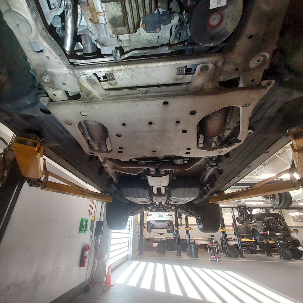

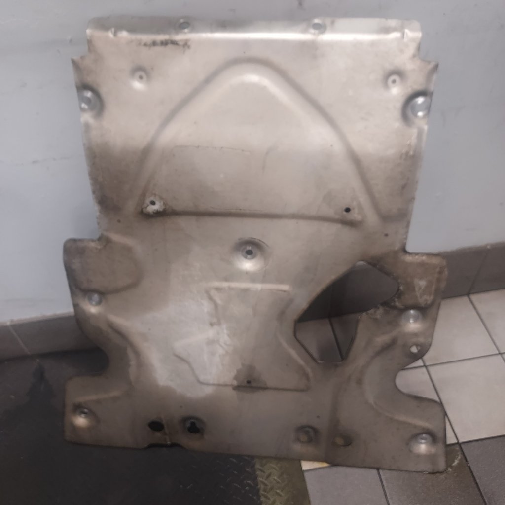

The OEM skid plates are aluminum.
There are two sections. Engine and transfer case coverage.
This is the front. 2nd one is for the transfer case.

There should be covers that run down both sides of the vehicle ( underneath). Those are just plastic.

There should be covers like those at the tie rod ends.
