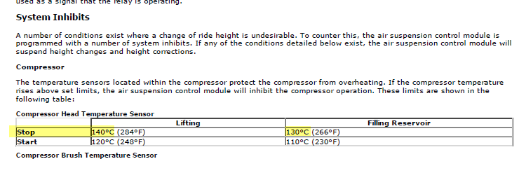

My shiny new compressor is no longer triggering the fault C1A20-64 (Pressure too slow filling), but the temps seem crazy high to me. Pressure takes 2+ minutes to climb to 250-255psi, and the compressor temp reaches 120-130°C. Then it turns off, and gallery pressure drops, and eventually the compressor cools. But this is awfully close to the max temps allowed per the FSM (screenshot below), and it just doesn't seem right.

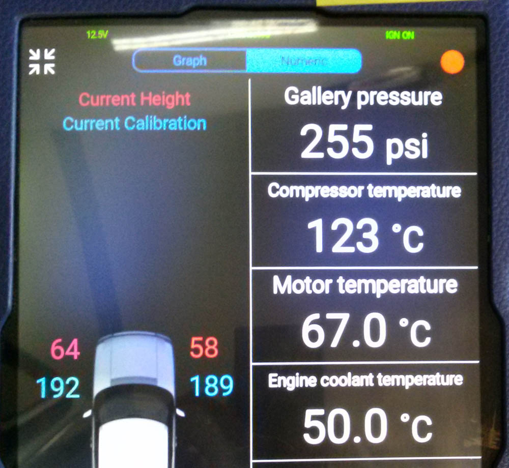

Got some pics, see below.
The "cold start" was with the compressor at room temperature (~35C), also note the motor is relatively cool, but the compressor head temp is high. This photo was seconds before cutoff, which was around 257psi / 125C compressor.

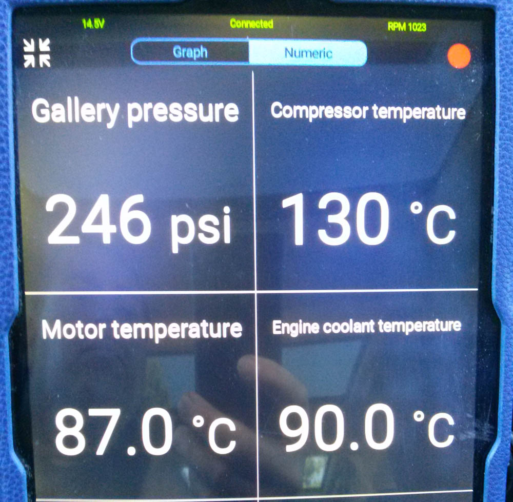

The "hot start" was after driving a bit and waiting ~5 minutes before adjusting height to make the compressor run again. Note the pressure is a bit lower, compressor temp a bit higher, but motor temp much higher (still plenty safe at <90C, I'm not concerned about motor temp in this example).
