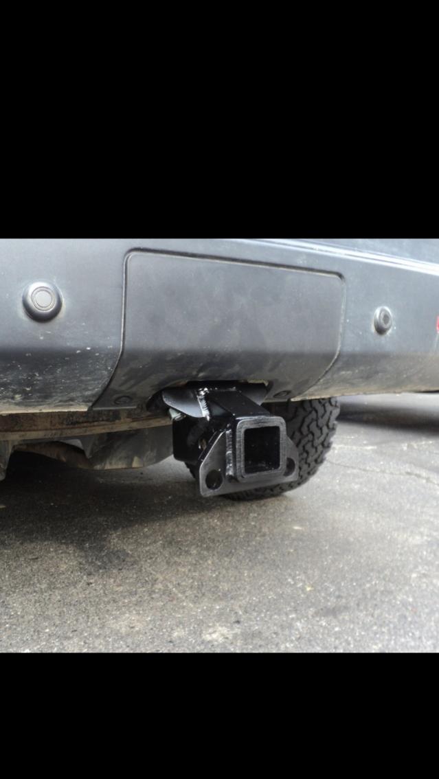

Hey CMGRover, yes that one from AB, and I also saw a couple on eBay for $200 shipped and $175 shipped as attached pictures (from eBay ads)

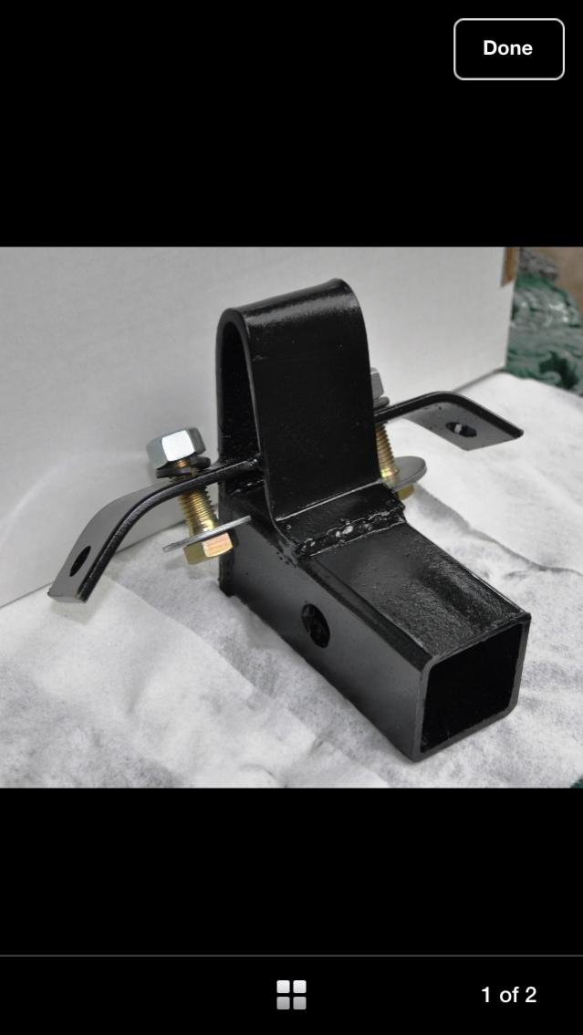

And this one...

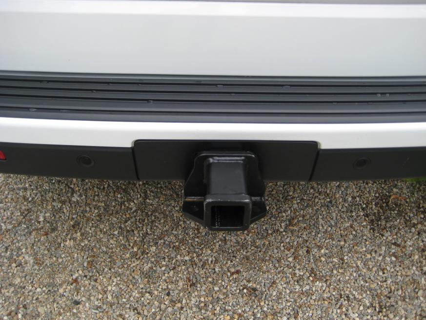

I have the Aussie one, $700ish.
