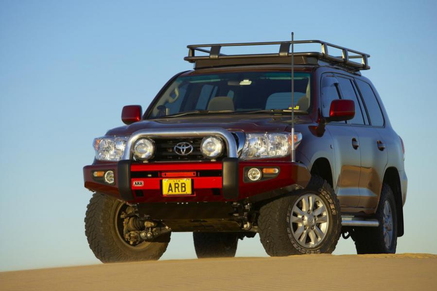

I haven't done anything on the front yet, I'm hoping for a new entry into the market. For me, the ARB is currently just too large. I like the other bumper that they make for the LC200 without the brush guard, but its not available yet. Anyway, thats my 2 cents. Good luck.

It is funny you mention this. I was considering what the ARB would look like without the bull bar.
Here it is on the LandCruiser. The chrome bar is optional. Its called the sahara bumper.
