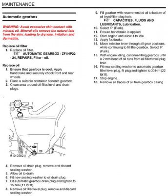

I have a 2004 land rover discovery. I am trying to add fluid to the transmission. I know that I need to add it in a plug in the side of the transmission. The only plug I can seem to find is on the side of the transfer case. Is this the correct plug?

No, the Transfer case is a separate unit.
