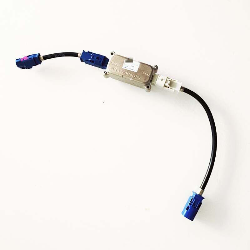

These are the part numbers for each equalizer.
LR031211................ Equalizer kit black circuit - front right - Range Rover Qty: 1
LR031213................ Equalizer kit white circuit - front left - Range Rover Qty: 1
LR031217................ Equalizer kit purple circuit - right mirror - Range Rover Qty: 1
LR031219................ Equalizer kit green circuit - left mirror - Range Rover Qty: 1
LR031212................ Equalizer kit black circuit - front right - LR4, Range Rover Sport Qty: 1
LR031216................ Equalizer kit blue circuit - rear - LR4, Range Rover Sport Qty: 1
LR031218................ Equalizer kit purple circuit - right mirror LR4, Range Rover Sport.

I saw that but the connectors on the module are not the same as the equalizer, I have seen this is the case in Volvo's too. I suspect they are to be installed else where. I've looked in the rear hatch, quarter panels to no avail.

The blue connector can be removed.
Pop the pink clip up, then slide the blue piece off.

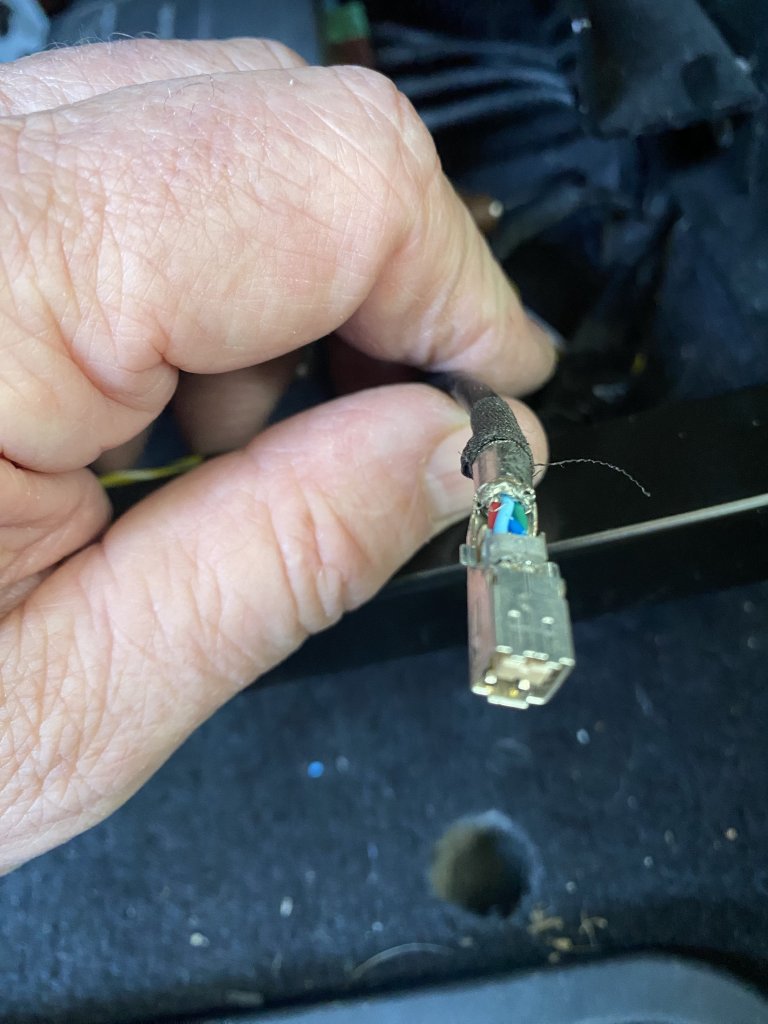

trying to post the pics, I have ended up still with 2 different coax connectors . One square ( multi cam box under seat ) and one round (equalizer) connector so I don't see how to swap them. Both are crimped and soldered .
