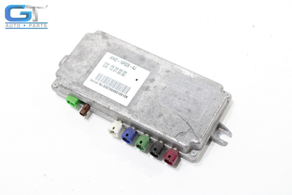

The 5 connectors on the right are the inputs from the cameras.

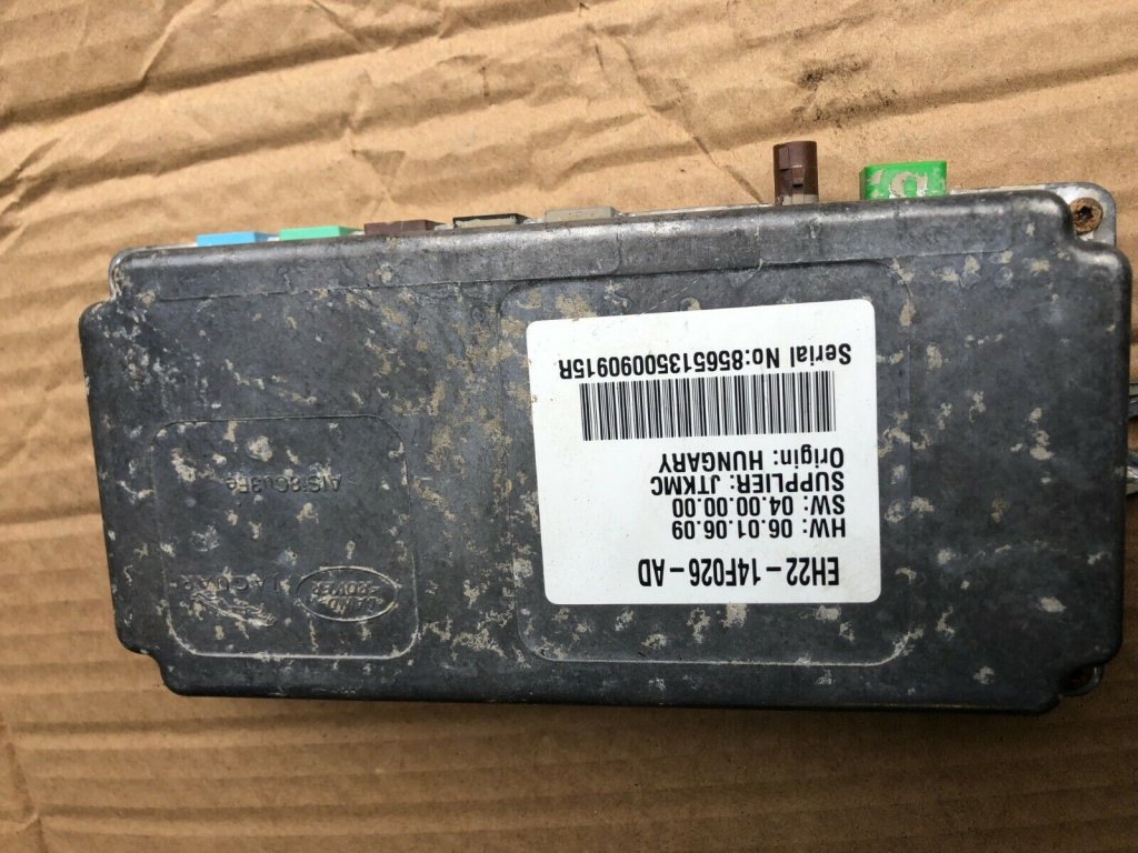

Thanks, this isn't at all what is under the drivers seat in my LR4 . I have only the square connectors like the one I posted earlier
Mine is not as salty as this one I found online for reference only.
