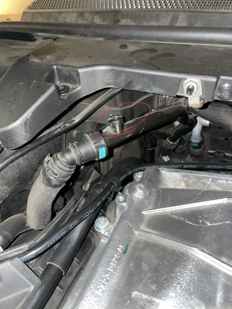

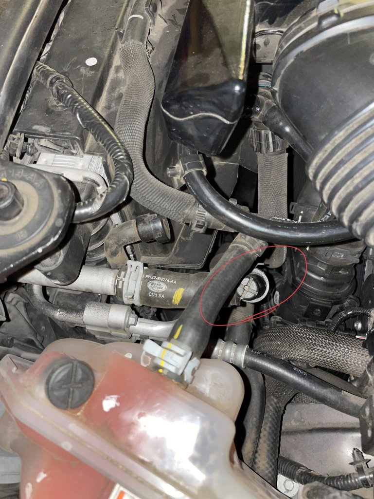

Pics below. Maybe you don’t have them on the pre-2014 models?

It has the one in your 2nd pic towards the back of the engine, one on the crossover pipe and on the expansion tank. Yet to find one on any pipes near the radiator.

Thanks for confirming only three. Radiator pressure tester? - no. Why would I need one?

Did Jlgir4's procedure with the 3 bleed valves. Worked like a charm!
