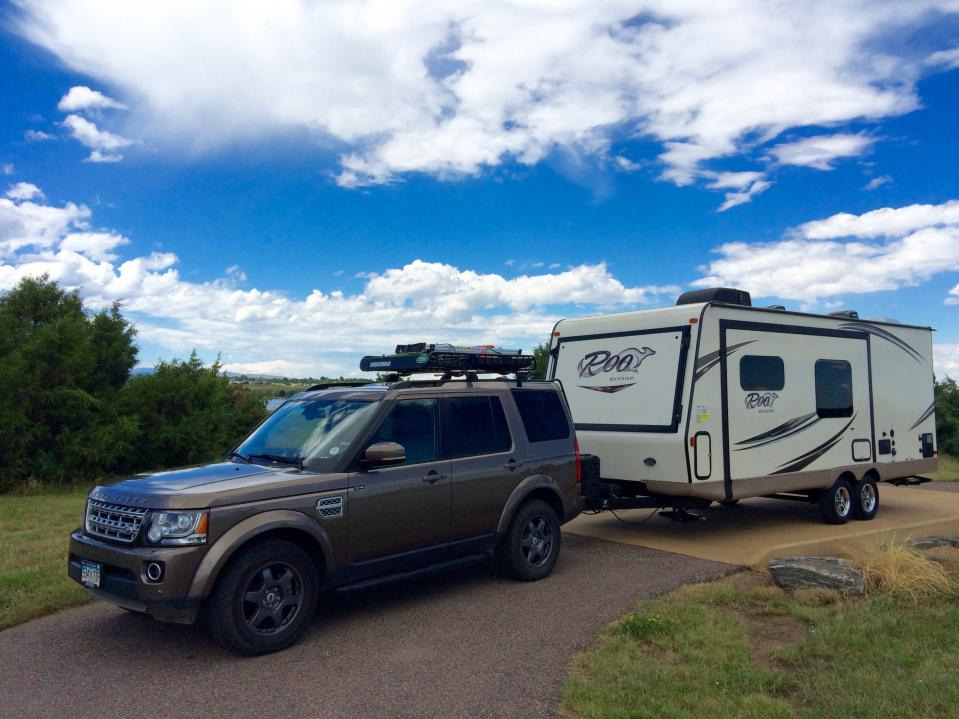

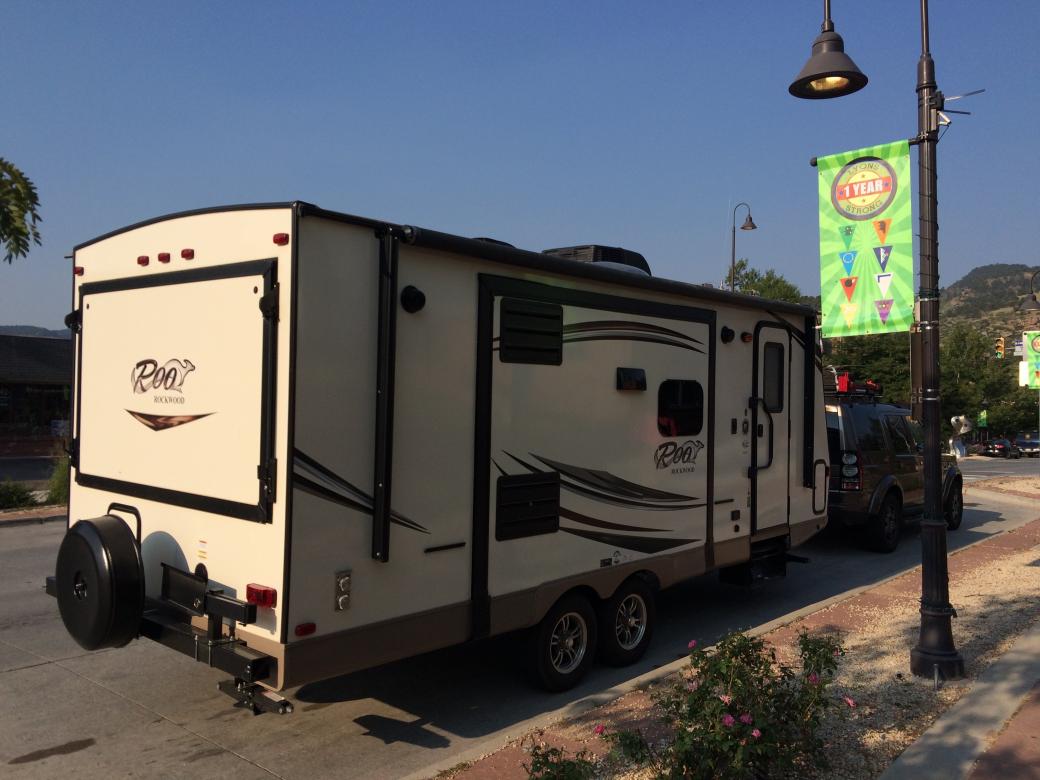

Here is my setup. 5100 lbs dry. About 6,000 lbs loaded. (Max GVW is 6,500). Just under 25' in length when towing. 11' high.
Curt Class III receiver. Hensley Arrow Cub hitch. And, yes, it is more complex to hookup and unhook. And, yes, due to the higher tongue weight (I have weighted it at around 650 lbs) and the various concerns and absence of commitment from Land Rover regarding their "plug and play" receiver I installed the Curt which has forced me to put a "toy" spare tire underneath. During off road season I put my off road spare on top.
I pull it with a 2014 LR4 w/ the SCV6 and 8-speed transmission. I have the HD package and there was one trailer site where I had to pull it up a steep hill at no more than 10 mph. So I just dropped it into 4L and it worked great.
Anyway, pulls great here in the Colorado mountains.
Maybe I'll see you all out on the roads some time. If I do, be sure to say, "Hi"!
