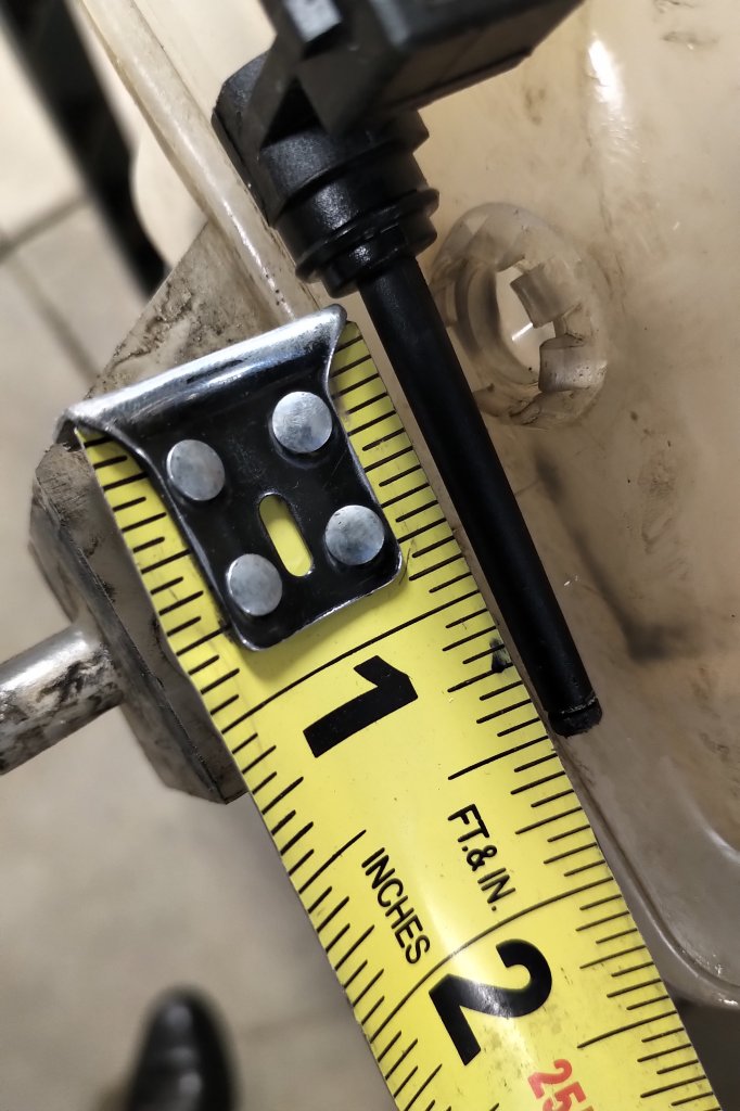

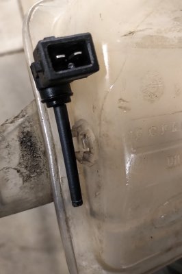

I removed the float sensor in the LR3 coolant expansion tank and took a couple of pictures per below.
The float sensor is about 1.5" long per below and the "dimple" that it sits within is about 2" deep.
The float sensor remain dry at all times and relies on the vertical movement of the internal wetted float.

The whole sensor system is stupid. By the time the sensor triggers low coolant from a puking crossover, the engine has overheated and has taken the heads with it. You now have a $10k paperweight.
