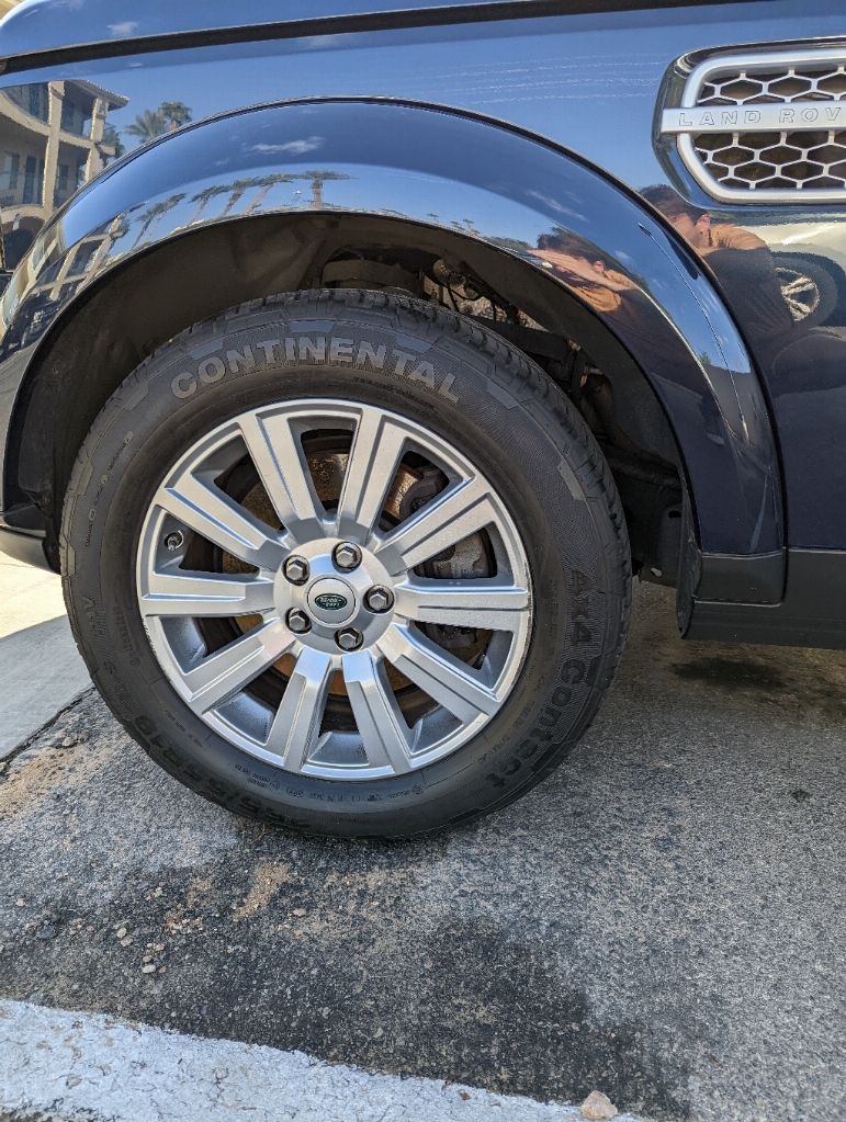

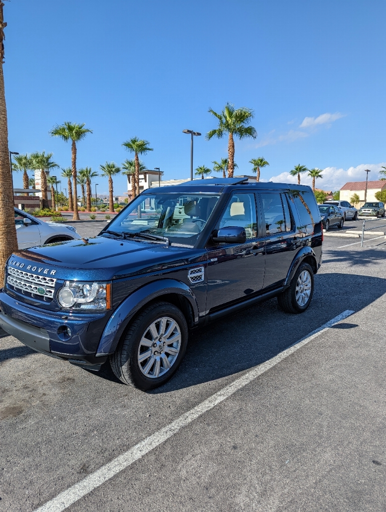

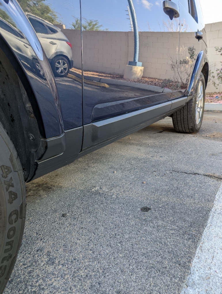

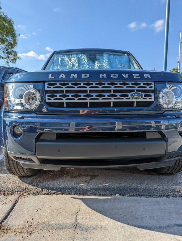

I applied some Zaino Z-16 to all the exterior plastic because it has UV protection and I live in a high radiation area. There is a surprising amount of exterior plastic on the LR4 including the windsheild nozzles on the hood, headlight nozzles, ground effect panels, mirrors, the cowel thing under the wipers, bumpers and Z-16 is also a tire dressing so I did the tires too. The aspect aside from UV protection that I like is a newness effect where it darkens the material slightly without a greasy look. Its a silicon based chemical. Overall the LR4 looks good on the outside for 98k miles and 11 years old. Pictures don't do it justice.
