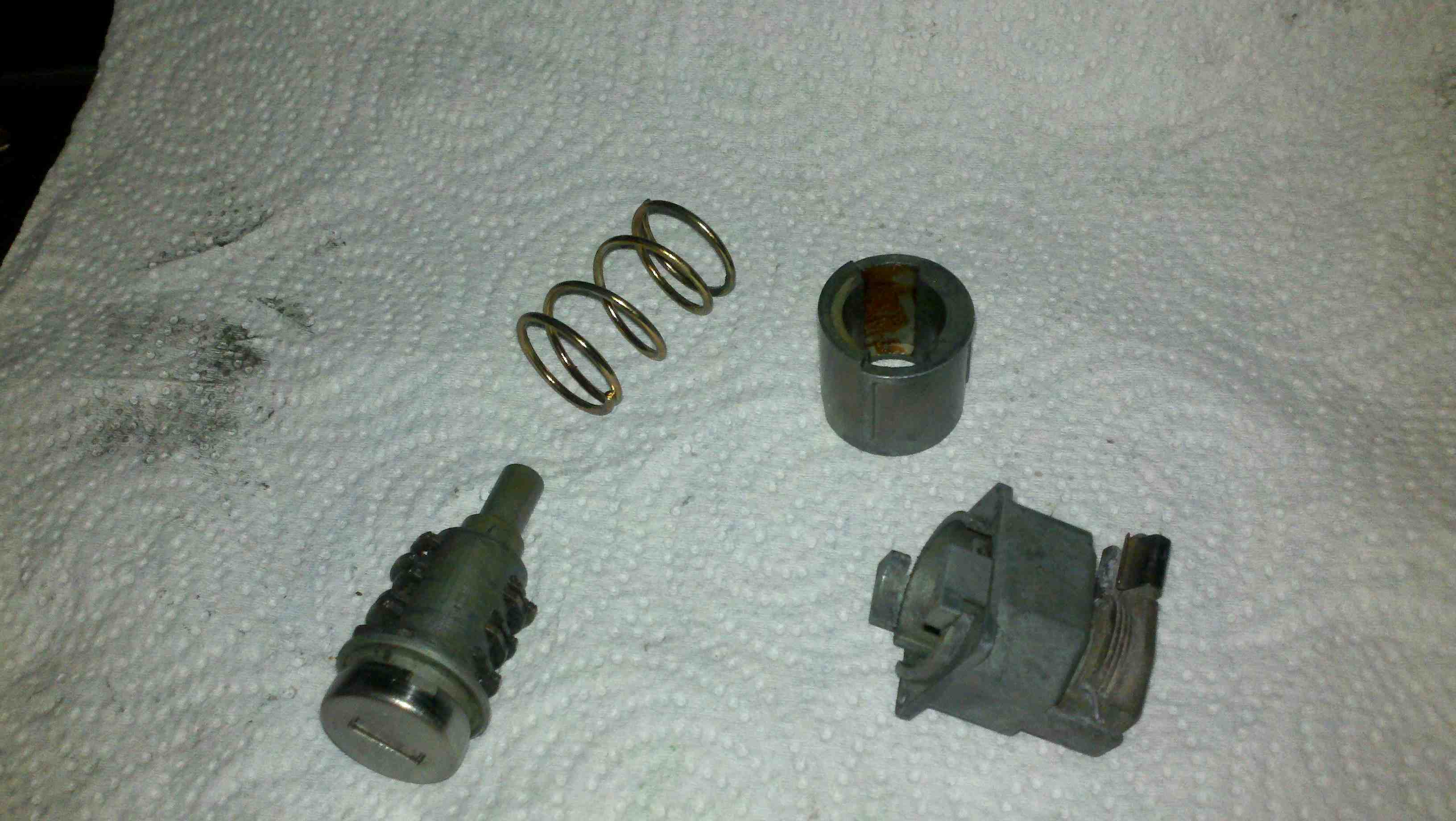

Hi! I've got a '95 RR that I have coddled for some time, and now everything seems to be falling off or apart!
Just recently the door lock fell into the door, then fell to pieces. Four pieces, to be exact (see photo I hope attaches :biggrin:). Does anyone have any idea how those four pieces fit back together?

Probably best to buy a new used one... or take it to a locksmith. I don't think I have a parts breakdown that goes there.

the proper repair
Dealer can order for under $100. Takes a few weeks but a brand new assembly I
s what I recommend. Dealer also provides a repair kit with a pin and spring and plastic rocker/cam.
