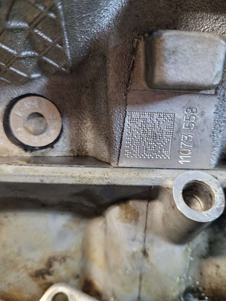

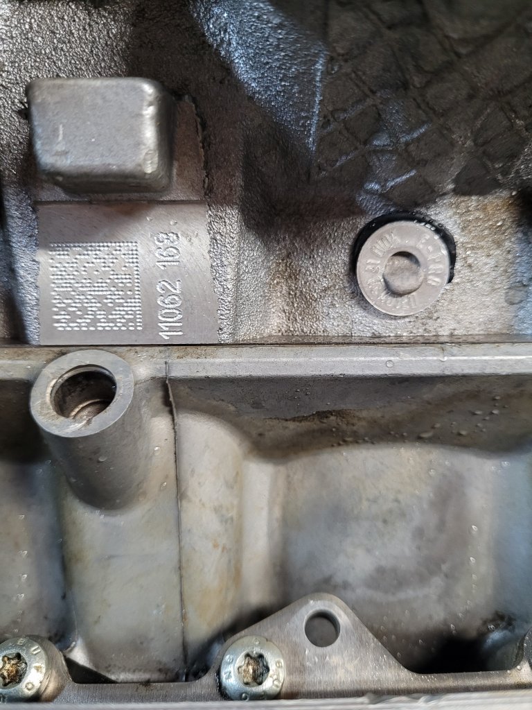

Has anybody seen or heard of these guys? E-Pro buttons glued to each cylinder head for an LR4 I just purchased. Thanks,

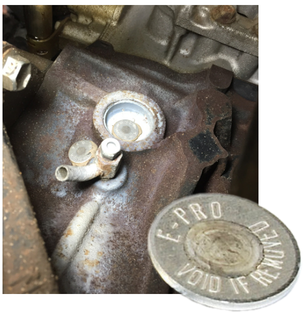

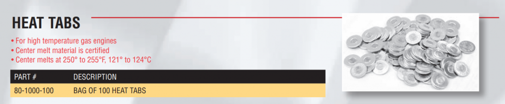

That is a heat tab. It is supposed to have the center melt if the engine overheats (over ~120°C).
Question is, who applied it, and why? Can you check the engine serial and see if it's original? Could be those were applied to a used engine sold by a salvage yard... seems unlikely the heads were rebuilt.
Similar heat tab shown here:
E-Pro tabs on eBay:
Engine Pro / E-Pro tabs:
Screenshot from their catalog:

Thanks! Didn't know that. I bought it as a non running project. Engine is out and fully disassembled. It does not appear to have been over heated. Heads were evenly tight with no mixing of oil and coolant. Plugs appear new, timing set it new, no wear on guide buttons! Right head has some clogged oil passages and 3 rod have spun bearings. I'll have the crank and rods checked. Block looks good at first visual check. I'll remove all plugs and clean all passages including squirters. Fun fact-it appears to be an SC short block with all other appropriate NA parts. I will replace the SC pistons with an NA set.
