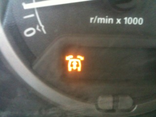

Hello,
My dad bought a land rover lr 3 2006 in Afghanistan for his business stay over there however he is experiencing a few technical difficulties for which he wanted me to inquire about. According to him the car was all fine until a morning when he started it and the air suspension wouldn’t work and all the error messages came forth.
The error messages are:
Special programs off
Suspension fault
System fault special programs not available
And an icon came up of which I have a picture attached.
I don’t think a Land Rover mechanic is in Afghanistan to help out lol.
These problems arose over night, any help would be greatly appreciated :)
Thanks,
Serialkisser

Have him get a new battery (or at least get it checked) and change the brake pedal switch.

Thanks for the response. I told him to replace the battery and googling the brake pedal switch to locate it im getting "brake light switch", are they the same ?

Probably....should be a part that costs about $15 and mounts up near the brake pedal stalk.

+1 on the Battery and Brake Light switch. Sounds like the problem. I do not suggest throwing just any battery in it. There should be a way to import it if needed, perhaps coordinating with the Brits over there. I would imagine they are bringing in parts by the plane load to keep their vehicles running.

Below is a link to some material I have posted re replacement of the brake light switch. Also have him check the tail light bulbs. Did he replace any recently? If so, I doubt that genuine Land Rover were available. Chinese and Russian bulbs probably fit but are unlikely to have the same spec as EU manufactured bulbs. This does matter.

Battery plus brake switch for sure. In my case the T-Case ECU was bad, after battery and ECU all was fine.
