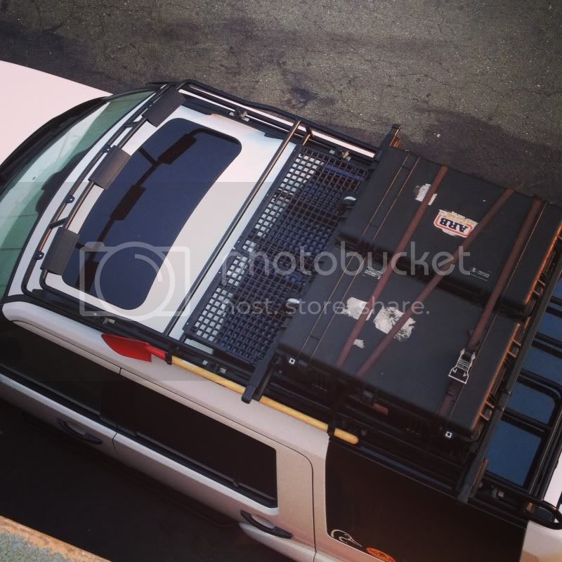

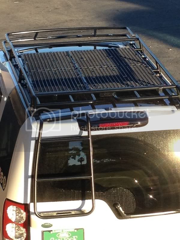

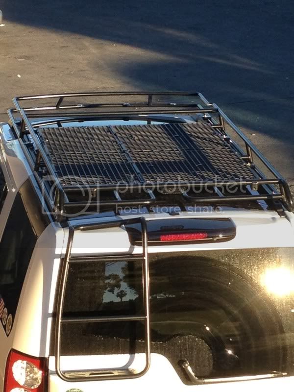

I used two pieces and got the type that overlaps, but it depends on how you lay down the flooring. I got a couple sheets that overlap and a couple that do not. I use industrial strength zip ties to keep it down and works very well. Here are a couple photos:

Thanks so much! I ordered 2 pieces. After reading many different forums this seems to be the best stuff for using as a platform on the racks. Great pics which really helped. Thanks!

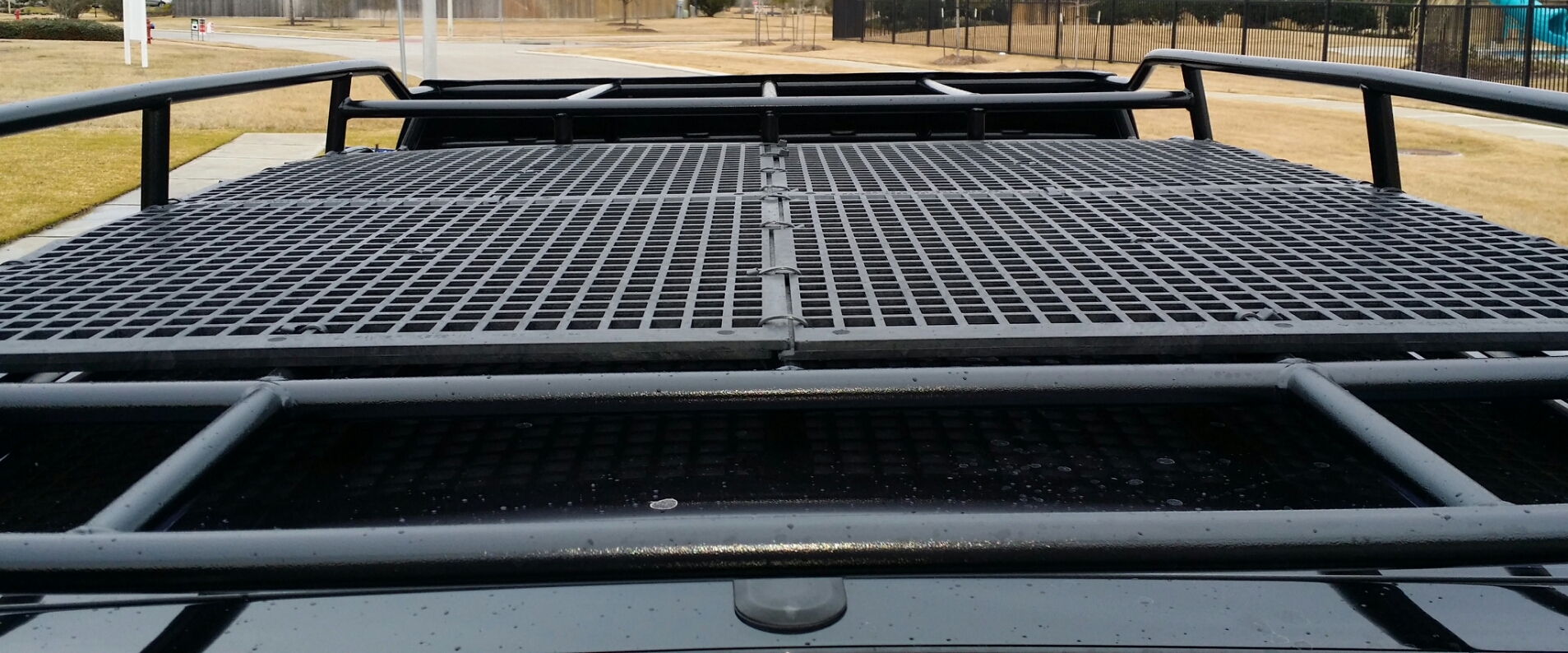

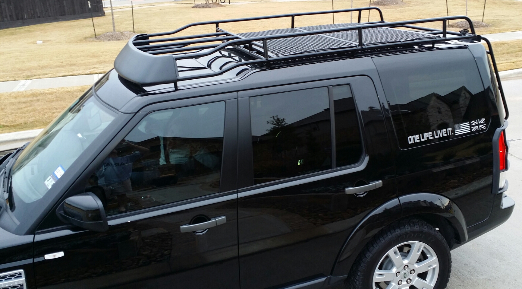

Here's my flooring, also getting a roof top tent. Hopefully everything will fit together nicely. Fingers crossed!

Looks great! I look forward to seeing your rooftop tent and how it sets up.

That looks awesome! Wow, Voyager has really made some great changes to their wind fairing. I had a Voyager rack on my 2011 and the old style fairing was horrible. I had heard they updated their design based on complaints - nice to see the new style looks great.
The flooring is awesome, such a cheap modification and holds the weight with no problem. I am up there all the time.
