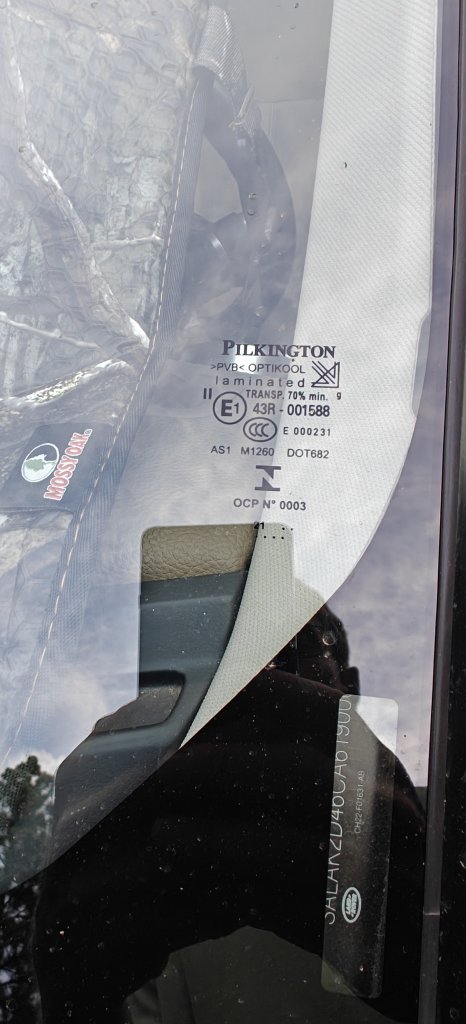

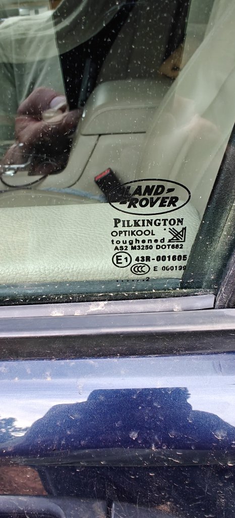

I'm not sure. All the windows have the Land Rover brand on them except the windshield. It has Pilkington but all the others have Pilkington brand too.

Always OEM clips and don't reuse. I am on the 5th windshield and have used them all; Pilk, Fuyao, PGW, St Gobain. So far the Fuyao has held up best but could be just luck.

If it's missing the Land Rover logo it has probably been replaced. The window with the vin in it doesn't exactly look perfectly lined up either.
Maybe that is why the pillar cover is not sitting right.
