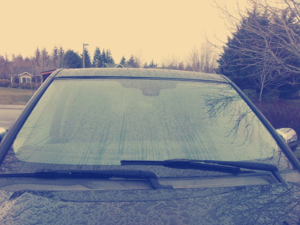

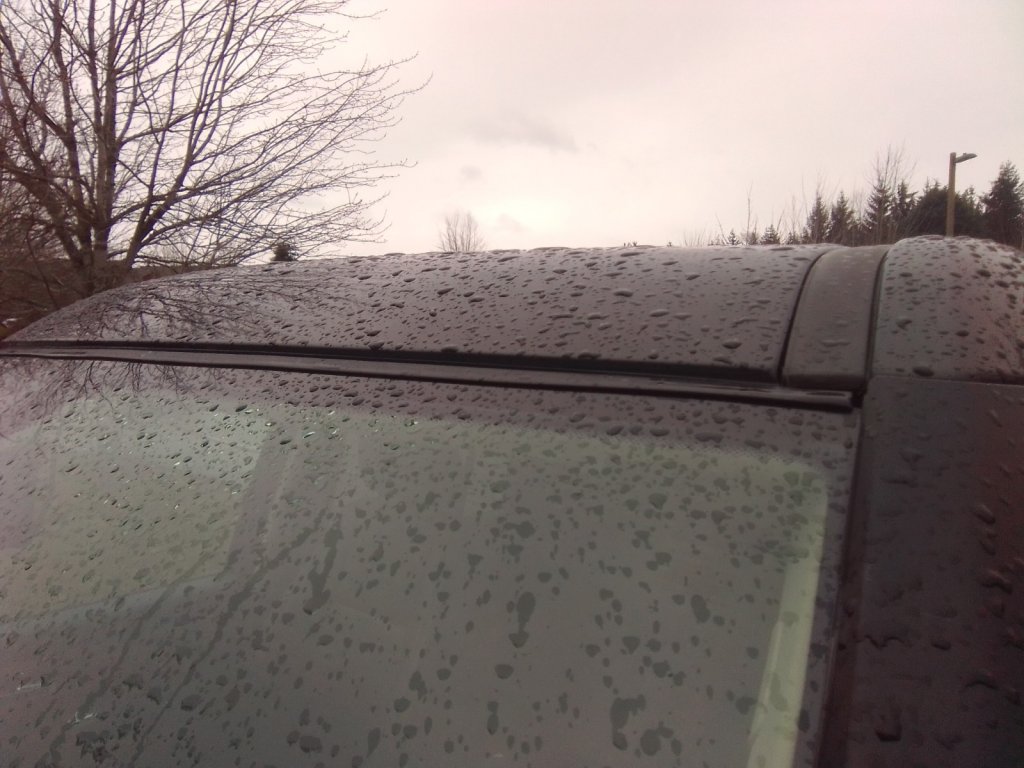

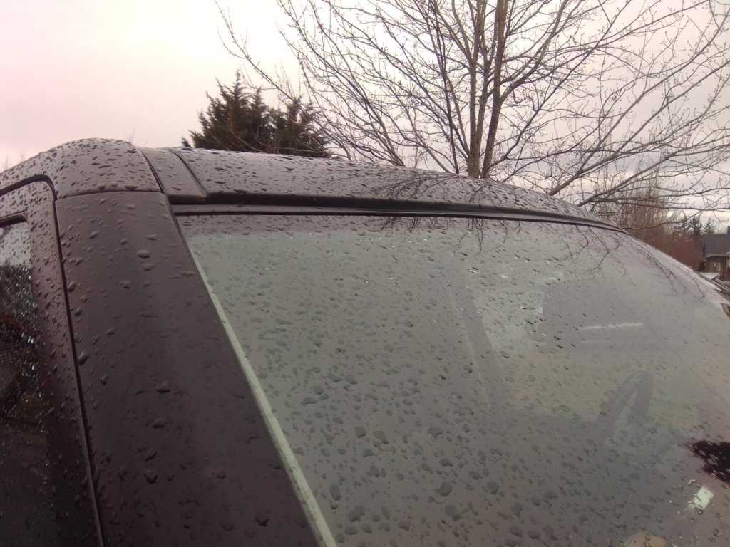

I have a noise and vibration at high speeds on my 2011 LR4, but I am wondering if it might be something that is going on with my windshield rather than the pillar clips. It's kind of hard to see but the top of the passenger's side of the windshield has a bit of a gap while the driver's side is flush. (See attached pics). It almost looks like a slight defect in the manufacturing of the roof where is comes together with the windshield on the passenger's side. Has anyone else come across this?

Badly installed windscreen. Could be the cause of the noise. Is it an original (LandRover or Pilkinton) windscreen? The non genuine ones usually have a poor fit and cause all sort of problems.
