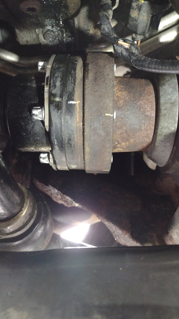

So heres where the first question i have comes in. About 20 mins after using full throttle for the first time i noticed a cyclical noise over 25-30mph, sounded like something on the driveline. It went away, then i noticed vibration under load that didnt go away. Got home and looked things over and noted i need a carrier bearing for the rear shaft, and the front driveshaft was loosely secured by THREE bolts! Apparently half of them didnt want to be of service.

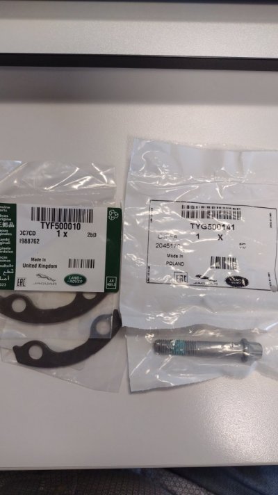

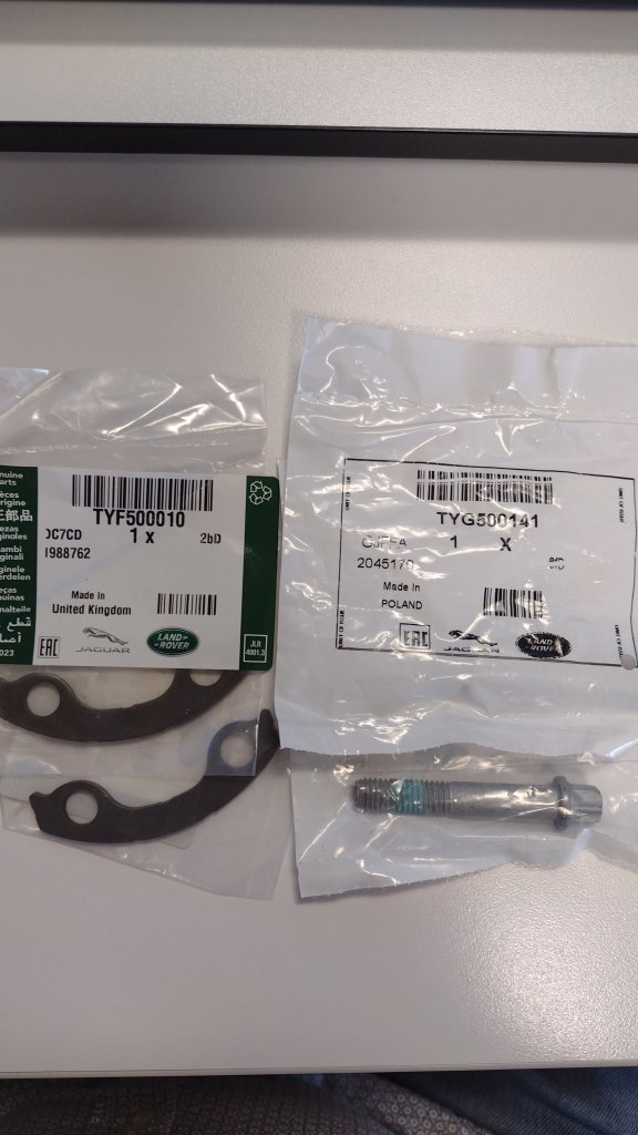

Bolts and half moon washers. Pics and part #'s
Bolts- TYG500141
"Moon plate" bolt backing plate - TYF00010
Forgot to ask earlier....Is this normal for a rover? To just shed parts holding rotating masses?

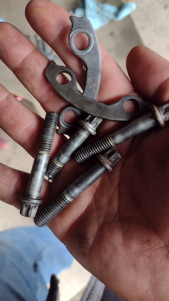

All fixed....lucky i had my 8 year old to hold the brake and release as I rotated driveshaft. Make use of assistants that will be paid in sour patch kids while I can! Also want to thank the JLR engineers, that heavy "parts grabber plate" on the bottom of the truck did its job, found these on top. I guess parts "skid" into them?
