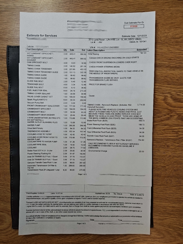

I got the revised quote and the grand total is huge but they are doing a lot of work and I'm hopeful they will do a good job. I'd like to get input on it though if anyone has any thoughts or sees anything else a bit suspect. I called the shop that did my a-arms for a 2nd quote on the trans filter and fluid and it was $100 more. The brake fluid flush seems high by $100, I think I paid $75 on my vettes but it isn't too high to where I want to buy a vacuum pump and DIY. I won't be changing it again probably for 100k miles.

why do they need 3 quarts of front axle fluid? Same with transfer etc?
That is a great question. If it were me doing the work I'd just drain what is there and refill. But the labor says they are doing a flush so I'm guessing either to pad their pockets or they would be using the extra fluid to flush out contaminants or clutch pack material? Is it even possible to flush the diffs and transfer case? I haven't been in there but I do know the diffs are advanced and do partial and full locking so if that mechanism gets material caked in there and it is physically possible to flush then it might be worthy of flushing.
But if it is suspect I'll bring it up since I already paid the deposit. I'm pretty sure they would correct it if its a problem.

There are 2 power steering flushing kits too. I should ask about why there would be 2 kits needed. I have a slight power steering moan that happens and he thought changing the fluid would correct it. But that might be a trick and I might be paying for a flush and then later a power steering rack lol. Any thoughts on that?
I actually had a whine/slight groan from my power steering and a fluid exchange did indeed fix it. I believe I made a post about my experience with that.

They quoted $8k for the timing chain work. But they also required changing the cam actuators (the parts that connect to the cam to change timing) because they too wear out from long oil change intervals. Normal quotes around here were $7k and nobody else mentioned the actuators. One Land Rover indy said he wouldn't do the chain because the engine could still fail later. I don't think he knew about the actuators going out.
