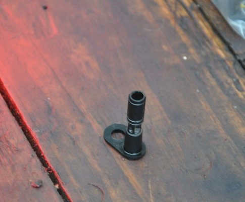

The photograph is what I found on the back of the cylinder heads (look familiar!?!) ….so seems like I will now be ordering some (more) items from Parts Geek soonest.
However, I am curious about the 2011 Service Bulletin mentioned by @Rover Range in another related thread about this part # LR011688 -
https://www.landroverworld.org/threads/oil-anti-drain-valve-in-top-of-engine-block-5-0-lr4.45134/
Is there a reason for this Bulletin? I want to replace this part because it is an oil restrictor (and I would like to free up as much oil as possible) as well as it is this tiny plastic part pretty deep in the engine (and certainly don’t want it to break!) Nothing has broken (yet) but I think prudent to be safe rather than sorry.

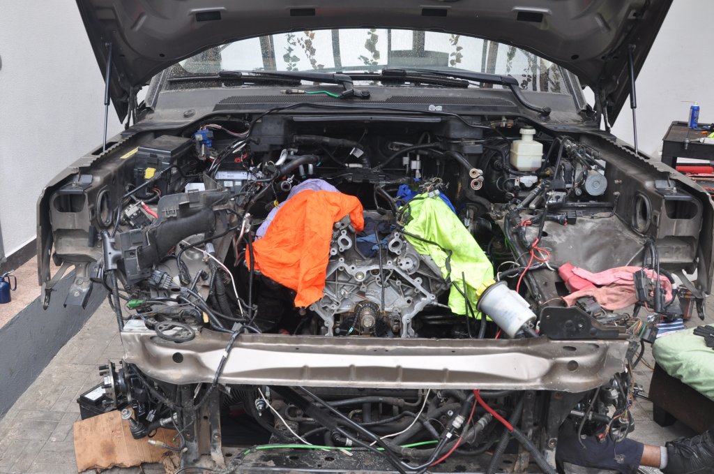

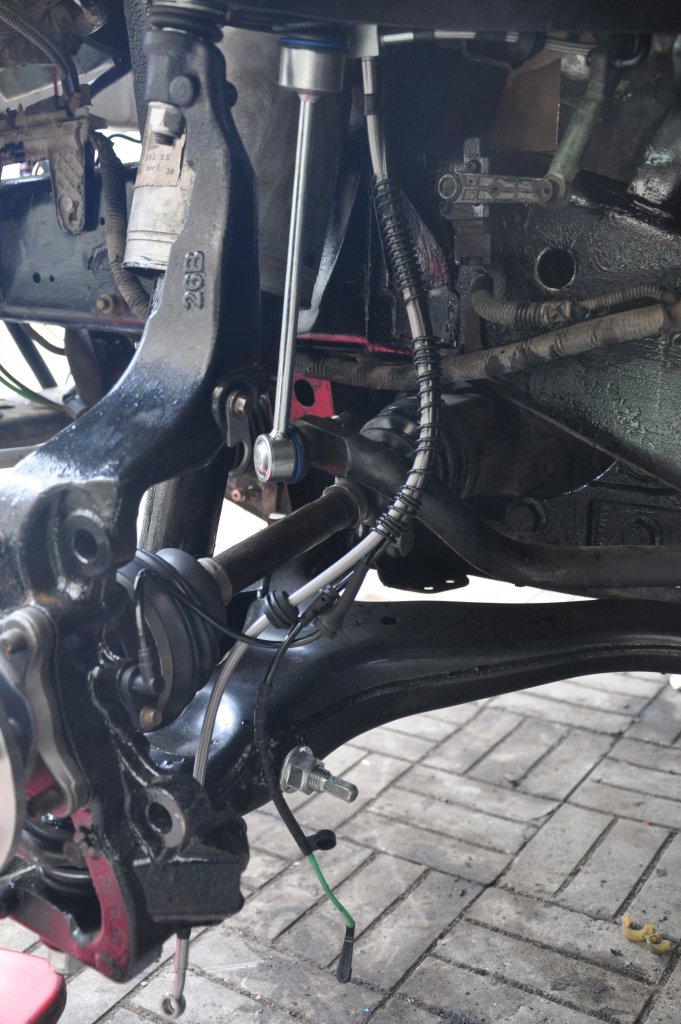

Meanwhile, the cylinder heads went back on today and got torqued to spec (photo below after wrapping up this afternoon including a friend underneath putting in new O2 sensors after finishing the exhaust headers reinstall).
So we will now have to wait for all the last minute parts I had not expected (these silly Oil Restrictors, two new High Pressure Fuel Pumps (why not?), another new (OEM this time) Water Pump...). We will therefore instead start working on suspension and brakes.

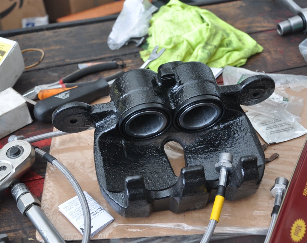

Now transitioning to the brake rebuild after fitting new control arms & hardware, links, bushings, and hubs+bearings to include some snazzy gloss black paint to spruce things up...

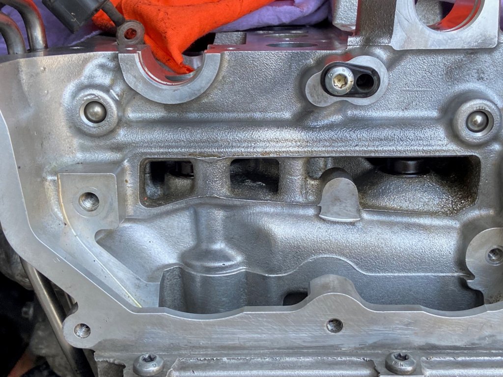

So, we have put the cylinder heads back on and here is where that pesky oil restrictor is located (the plastic piece). Since these fits behind the camshaft variators on the FRONT of the cylinder heads (I think I accidentally said on the back side of the engine previously), we will have to wait until the new plastic pieces arrive before we can proceed with finishing the timing (this photograph shows the old restrictor which is just placed for testing/fitting; we will replace it with the new ones once they arrive).
Regarding the other plastic valve (on the back of the engine) – we just cleaned everything up and reused it. If I could easily get my hands on one, I would have replaced it but alas…not this time (now I know!). These plastic parts.......
I have a photograph of the other side which doesn't have the plastic part installed yet.
Once we get this resolved, we will be ready to proceed with the rest of the engine rebuild....

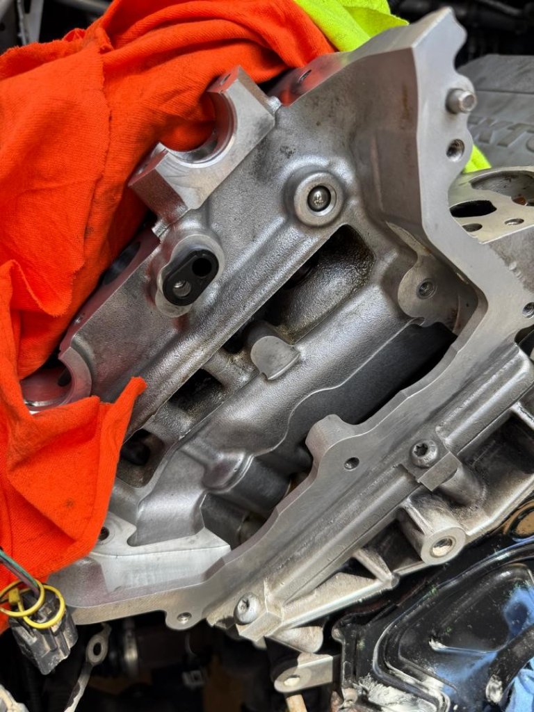

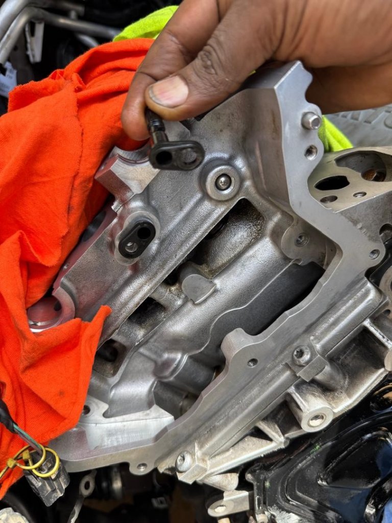

Update for mid-May: New oil restrictors back in. Setting timing under weigh.
No issues putting the new plastic bits in (once they arrived) back in and bolting up. Everything went smoothly and like the 10 Nm suggests - finger tight.
Old ones just seem to be brittle and then snap / crackle / pop.
Shown in the first picture is the old one next to the new one installed in the head.
Thanks for everyone's help and a number of silly plastic parts here which need replacing on these episodic maintenance programs which I had no idea that they even existed....
