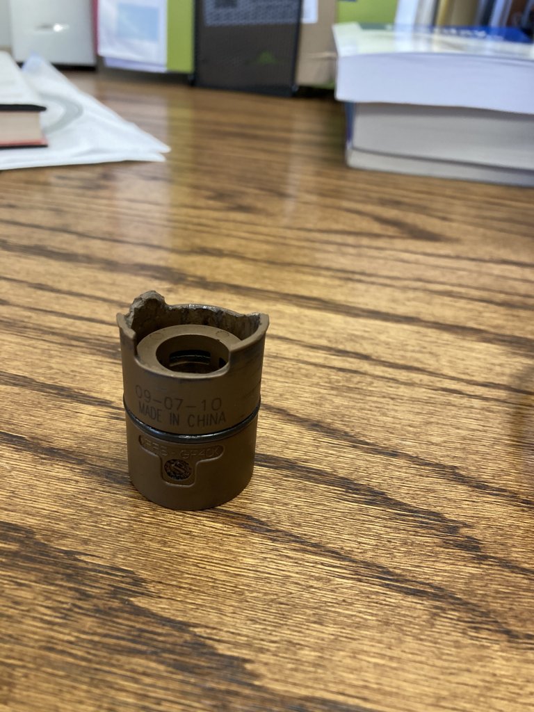

I am rebuilding the engine on my 2012 LR4. Block came back from machine shop and looking to replace what the manual calls the "oil anti-drain valve" on the top rear of the block. Sits immediately under the oil cooler. Anyone know where I can get one of those? I check with local LR dealer...they can see it in their diagram but say it only comes with a "short block" apparently. This is a plastic cylindrical valve that keeps the oil in the cooler so it doesn't drain back down into the engine. Can't believe there isn't one somewhere in the world...

Thanks Rover Range! Unfortunately that isn't the part. This part sits under the oil cooler in the block and keeps the oil from draining back into the oil pan after the engine is turned off. Here is a picture if that helps.

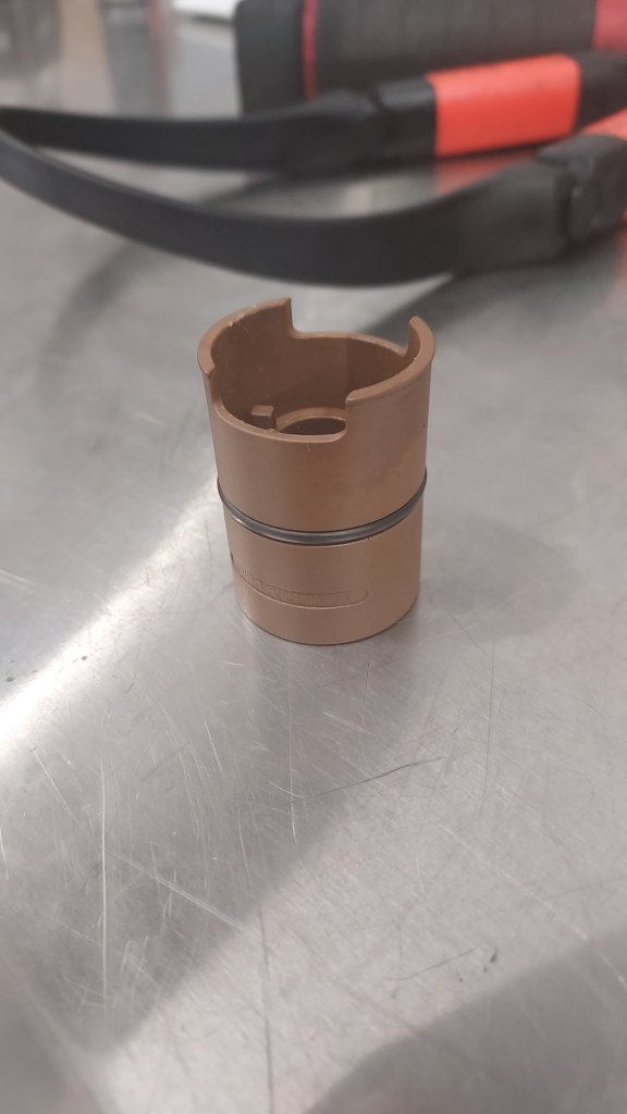

That helps. How soon do you need it?
We have some engine cores here that I can "borrow" those check valves from.

The ones that I got a hold off, was out of used engine blocks.
