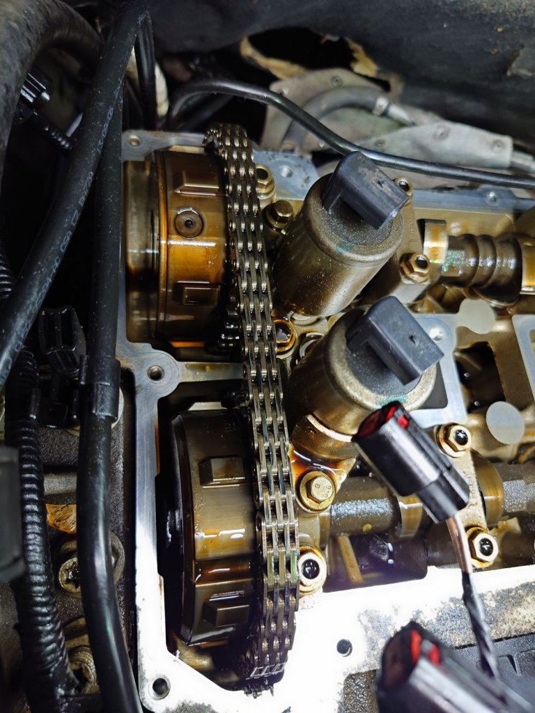

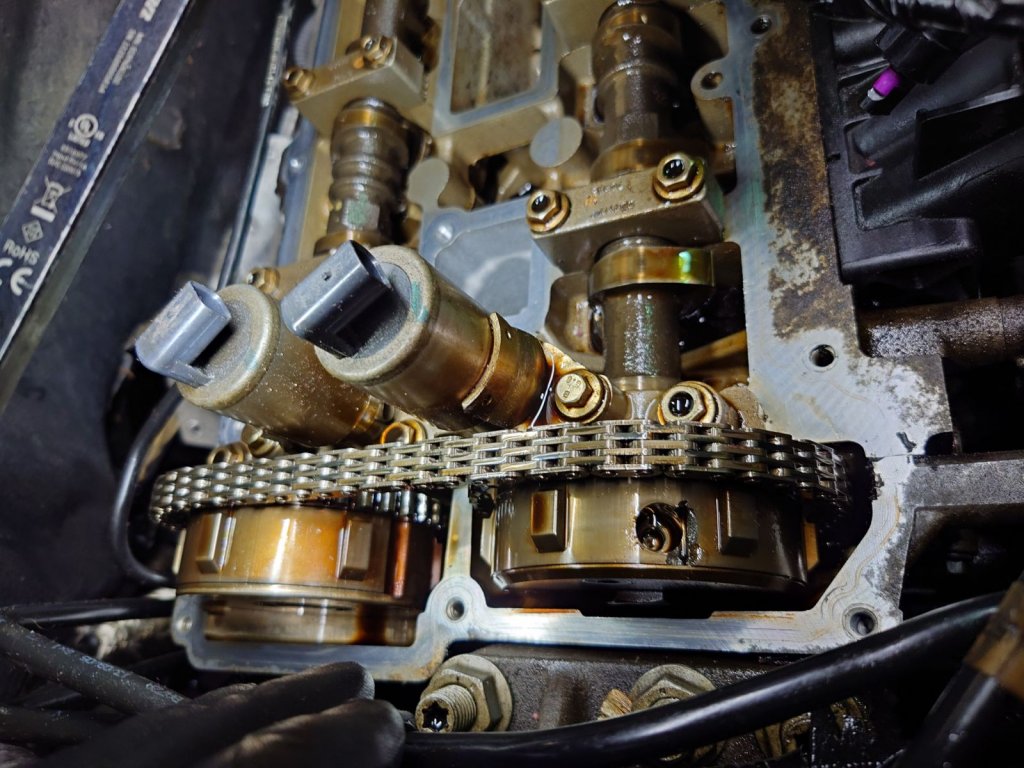

So after fixing the valve cover, they found that a cam shaft bearing was missing and most likely the cause of the metal fragments and breaking of the valve cover. This would most likely damage the cam shaft and maybe even the belt? What else?
The car runs well but what else can I expect? Pulling the whole engine apart to see what damage has been done is futile and expensive. Based on your experience, what have you seen occur to the car following this kind of damage?

That type of failure to the cam sprockets are not uncommon.
A rattle on cold start ups that goes away after a few seconds is an indication of eminent failure.
I really don't see metal flakes in the oil.
Maybe change the oil a couple of times every 500 miles.
Best thing to do is send an oil sample to Blackstone for analysis.
222,721
