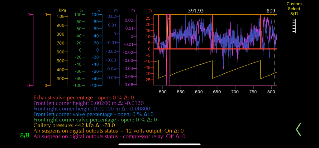

LR4 2012 front suspension going down overnight and I’m getting some logical errors
RLM-Suspension
  • C1A13-64 (AF) Pressure does not decrease when venting gallery - Algorithm based failure - signal plausibility failure
    ( on 01-02-2025 09:28:14 at 183183 km )
  • C1130-66 (28) Air spring air supply - Algorithm based failure - signal has too many transitions/events
    ( on 01-02-2025 11:00:33 at 183209 km )
Gap tool is showing an interesting sawtooth pattern. It shows the air pressure in the gallery, slowly creeping up and then the exhaust valve opening it again to dump it.
Since the front end is collapsing overnight, and I’m seeing this pressure creep issue, I’m leaning towards some kind of valve failure in the front control block
The air reservoir valve might be leaking as well, but that wouldn’t count for the front suspension collapse unless they both happen to be leaking
It’s the middle of winter here so I don’t have a warm place where I can spray water and soap all over my front system to check for possible air leaks. Does anybody have any other suggestions? I’m leaning to ordering a front air block and swapping that in to see if it fixes the problem.
