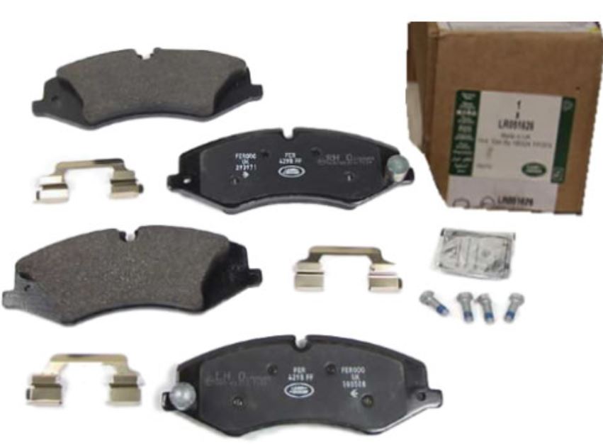

So I replaced the pads all the way around on the LR4 yesterday. EBC sent me what looked to me a normal pad. The OEM pads had a approximately 1cm diameter and 1 cm tall.
Two questions. 1st is what the hell is this? 2nd I replaced the pads is this going to be a problem?

you either are missing a picture or missing words that allow me to understand what you are talking about.
1,860
If I understand you right, you are talking abut the solid metal cylinder that is on the back side of the brake pads. If I had to guess, it's something to attenuate resonance in the pad.

I have them on my EBC green box, and it is a basically a counter weight to reduce squeaks, and brake noise.

The placement of the cylinder weight should be mounted in the outer position on either side and towards the top of the rotor when mounted on the vehicle. See the attched picture, while it's not the best picture, the OEM pads are labeled accordingly.

And yes, the cylinder on the OE/dealer and OEM/Ferodo pads is a weight that is a vibration damper.

So essentially throw an extra mass on it to change the resonant frequency! Was this a post design fix? Lexus used to do this regularly for NVH (Noise Vibration Harshness).
