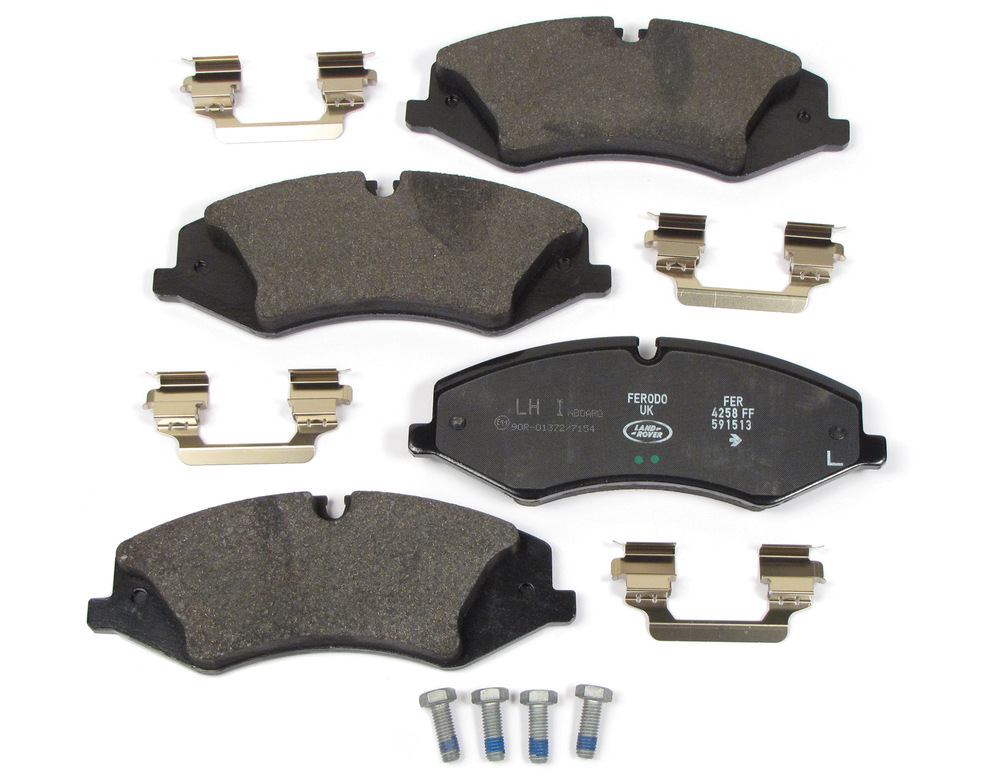

Here are the current links to the ones that I purchased from FCP:
Front: https://www.fcpeuro.com/products/land-rover-brake-pad-set-ferodo-lr134700#description OE spec and fits 2010-2016
Rear: https://www.fcpeuro.com/products/land-rover-brake-pad-set-ferodo-lr015519#description OE spec and fits 2010-2016
I also purchased new wear sensors. Prices for them are higher now (what isn't?). There's a 5% discount code.
Thank you for the link. Through searching I found Land Rover stamped Ferodo pads so I assumed they must be OEM. Forwarded the pictures of them to my svc advisor and he said they are NOT the ones they use. Kind of confused by that.
