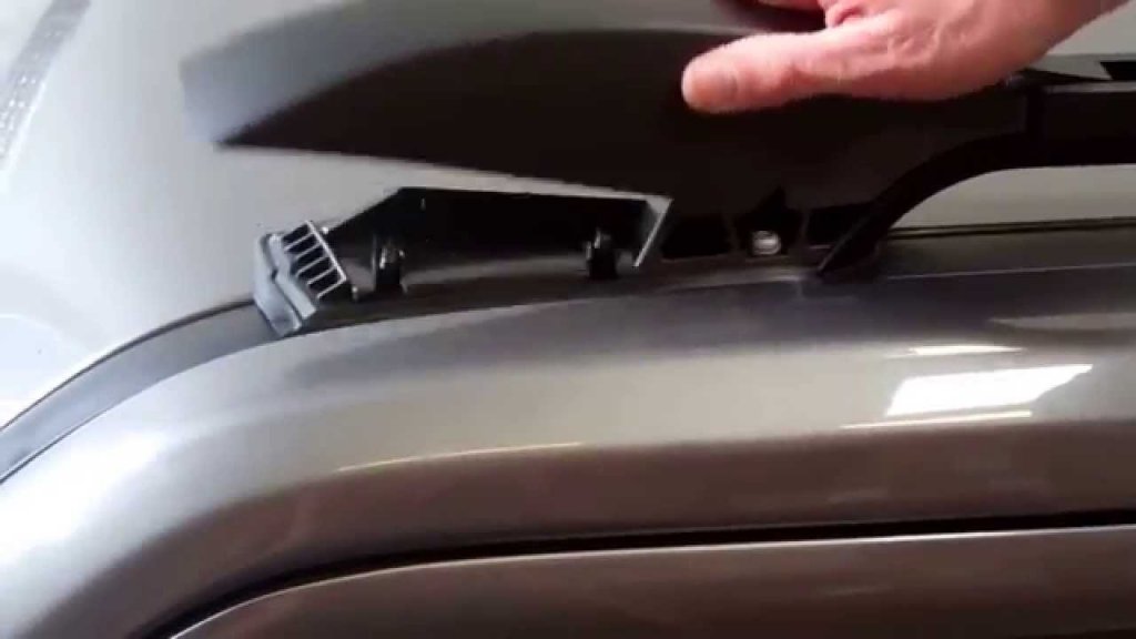

One more thing - has anybody actually checked what the OEM long rails look like when you take off the plastic cover panels? Rack manufacturers routinely say they can only go with short rails (or in some cases none) because they need the fitting points in the front. But I’m guessing (I’m away from my car now, can’t check) that since the plastic covers are fairly tall (3-4 cm), the metal part or the rail below them must be quite close to the actual roof and perhaps contains some mounting or other to which things could be attached… Which, if true, would solve a lot of problems:).

So I was kinda hoping to find a way to mount the rack directly to the front-most edge of my long rails (after taking off the plastic covers). I’ve managed to google out what they look like then. The photo is low-res but gives you an idea. Now, it there was a way to mount the rail on top of that lower end of the rail, I guess I’d be home at last:).

The FR piece grips directly to the rail and then bolts to the rack. Something like that might work in the gap in the front of the long rails. Unfortunately there isn't a similarly good solution for the back section of the factory rails.
Honestly I think you are going to have to compromise. Either you replace the long rails with short rails and go with the ProSpeed rack (lowest full coverage rack I know of), or you remove the rails entirely and go with the Front Runner (next lowest profile), or you mount a standard basket to factory crossbars and then remove the whole thing when you're not using it.
