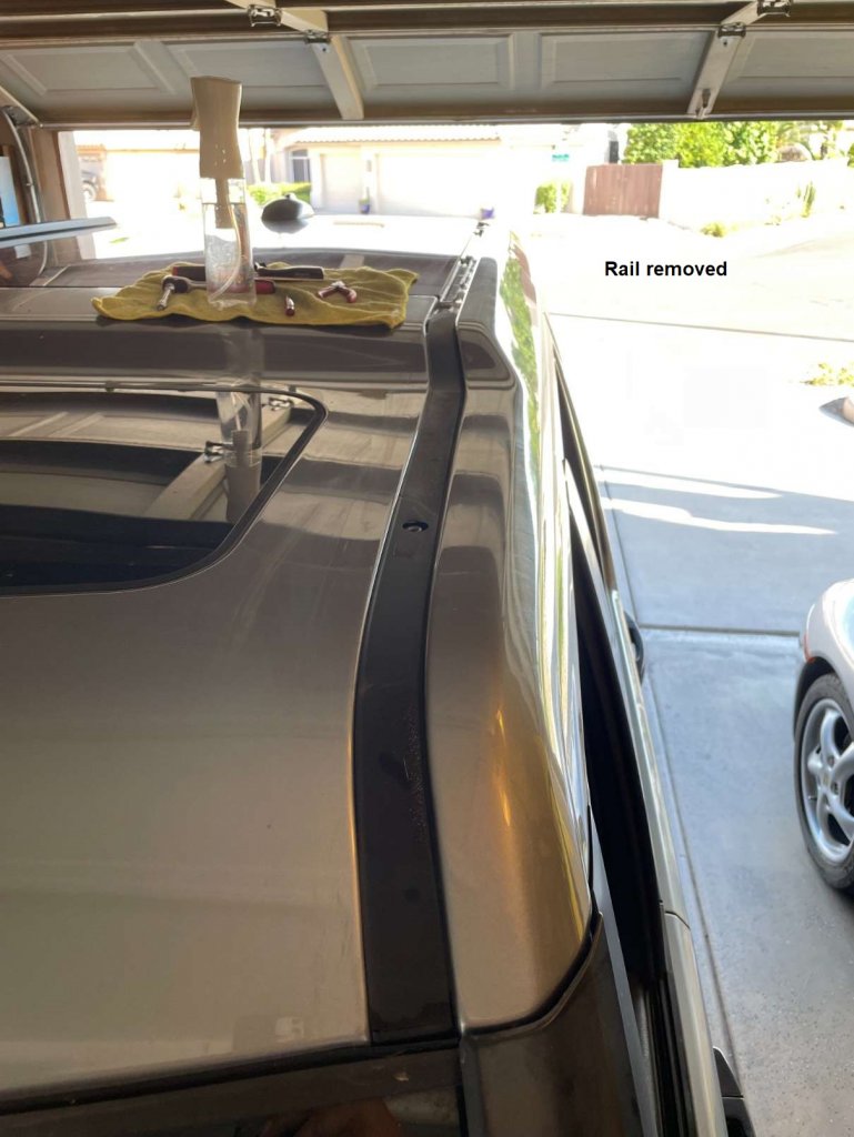

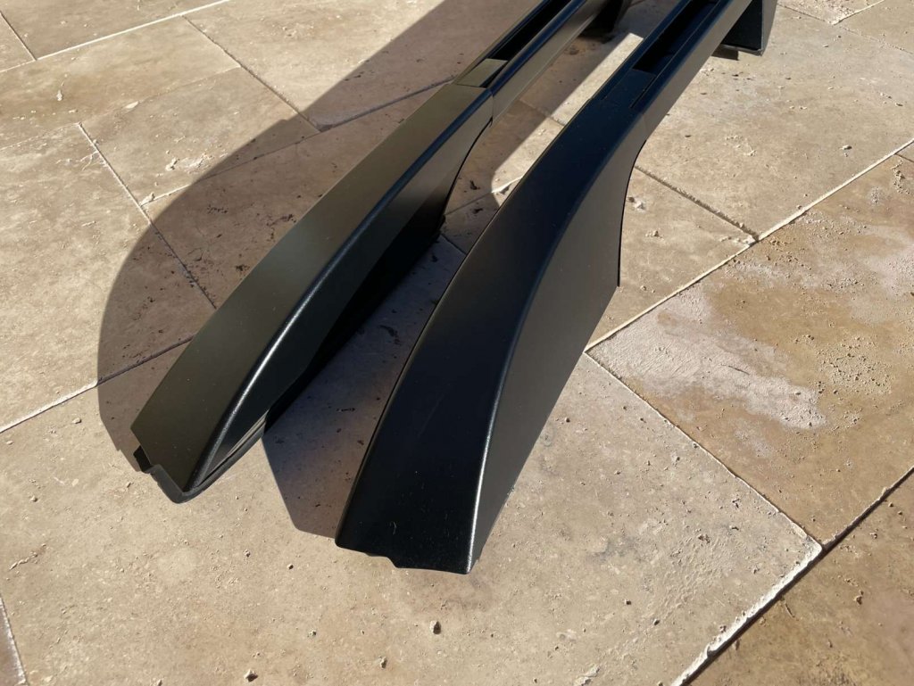

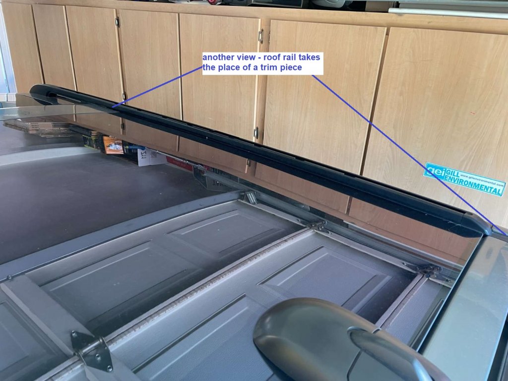

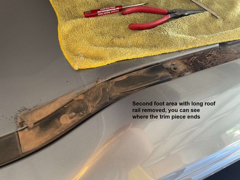

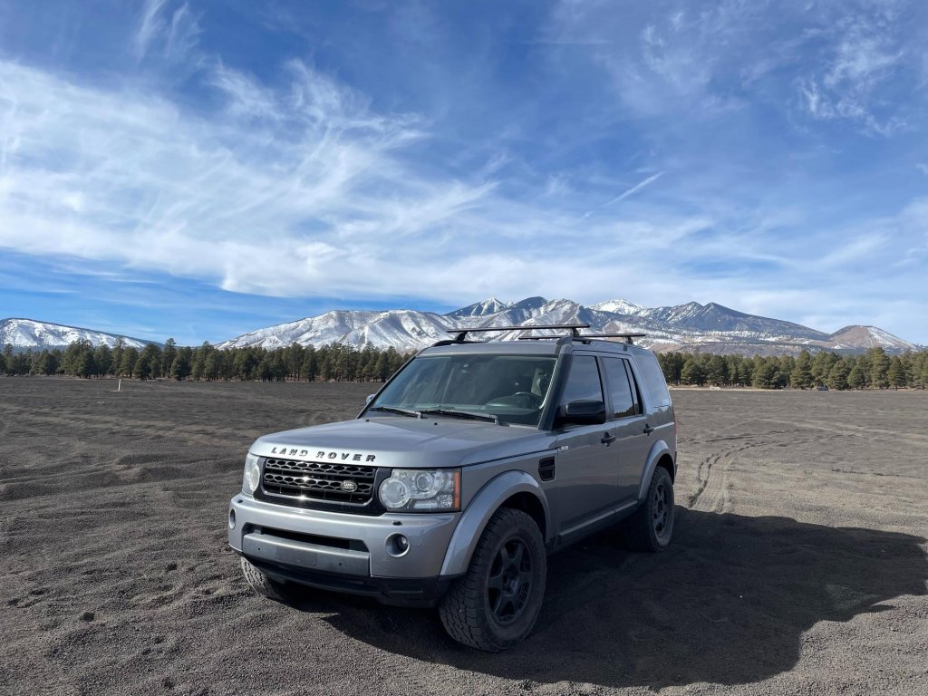

I have a set of OEM extended/long roof rails for sale as well as a pair of locking Thule Aeroblade cross bars. Here are some photos showing the OEM roof setup with the OEM extended rails.

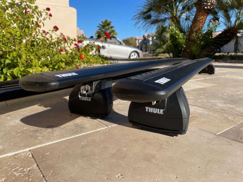

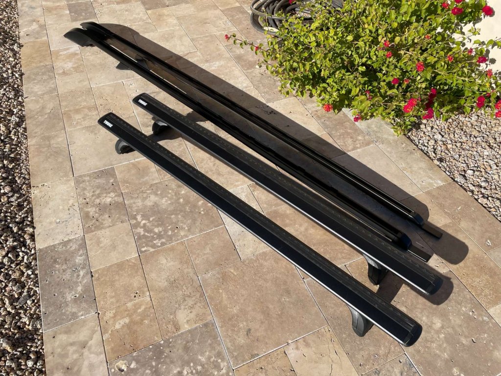

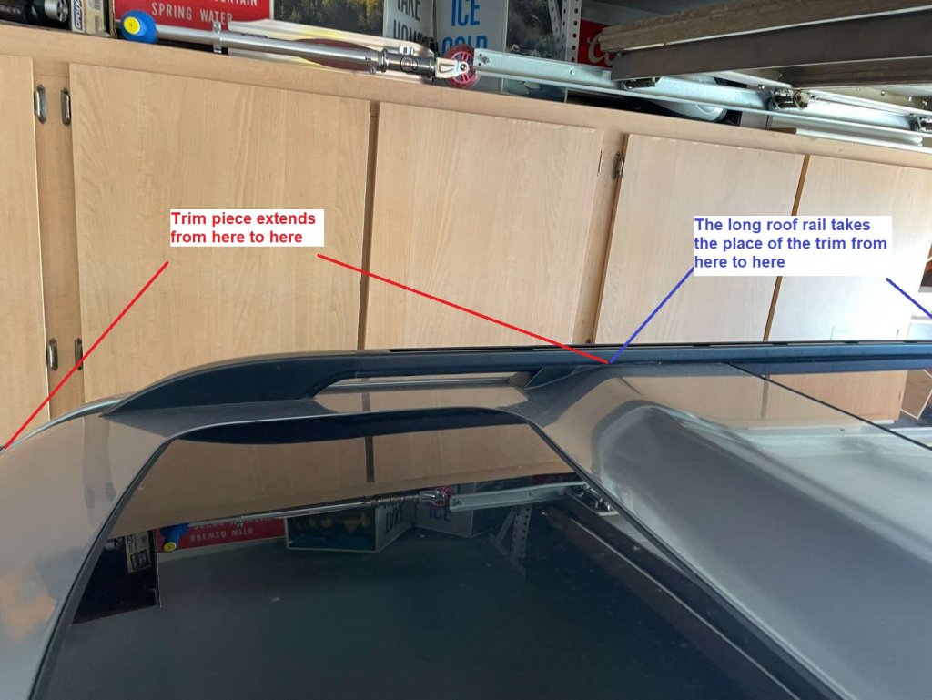

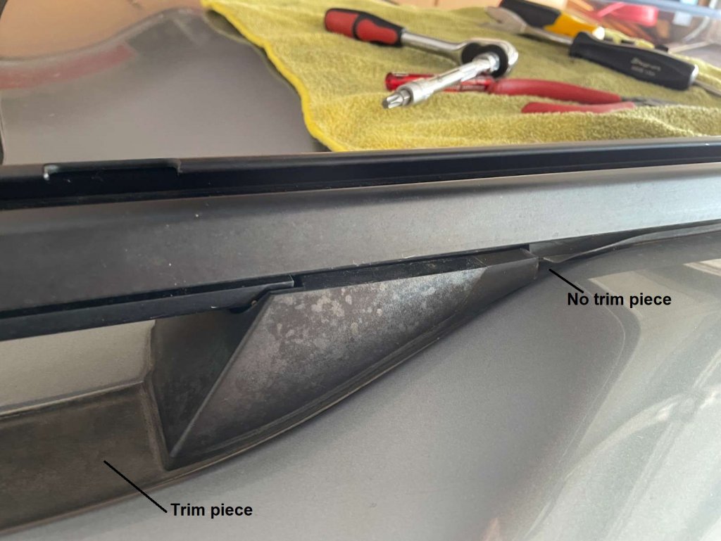

Original extended/long roof rails and the Thule crossbars. This stuff is just sitting in my garage in Scottsdale, AZ and taking up space. Would sell it in person for an amazingly cheap price. Will ship for a bit higher price, but still cheap!
