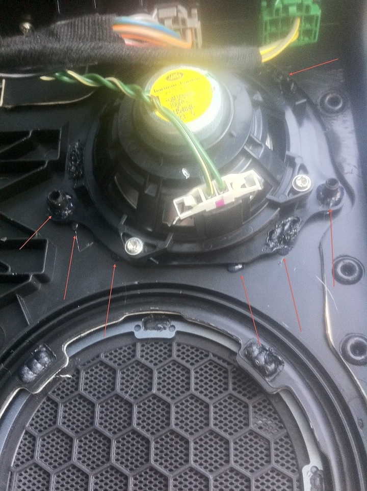

With the help from an older post and some additional innovation I think this is the BEST fix for the classic H/k Logic 7 rattle. Basically removed the door panel, and all the work was done on the mid bass speaker that is attached to the door panel (this is the smaller of the two on the door panel and not the tweeter).From an older post I read that the small mid bass causes all the rattle which is true. So in addition to melting the tabs that I simply grabbed a hot glue gun and put maybe 6-10 small blots of glue in areas that i pointed out with the arrows. AMAZING difference. took maybe 1 hr max.

And on a final note, everyone should do this. Its literally amazing the difference. Wow am I happy
