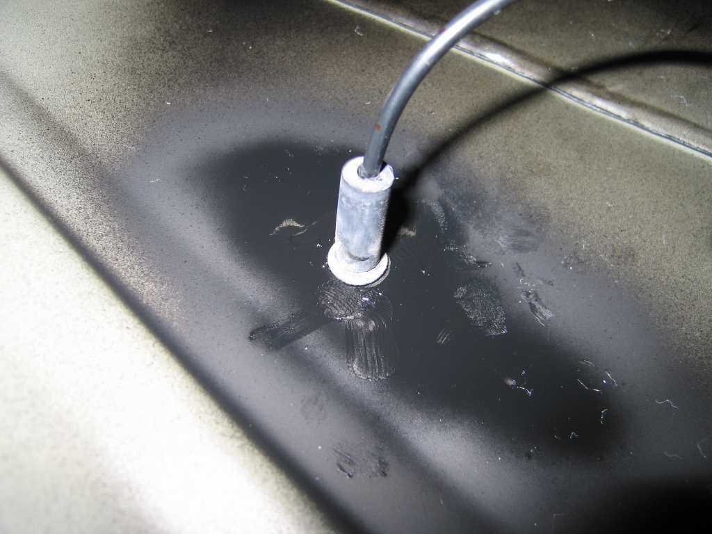

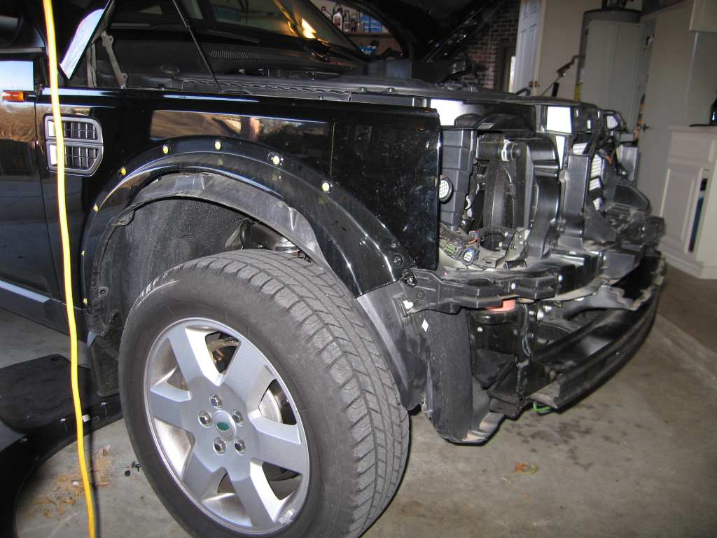

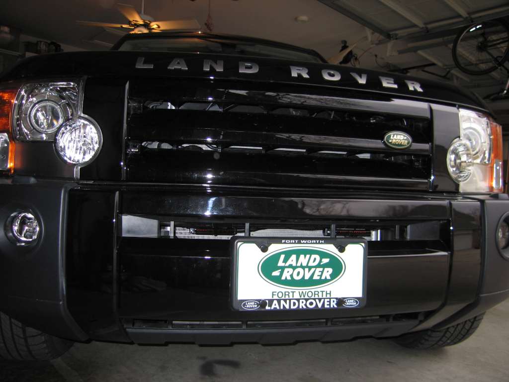

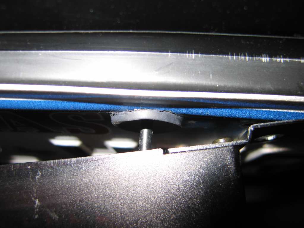

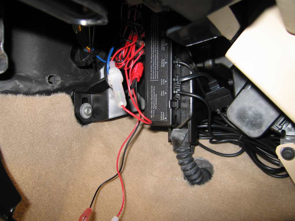

More pics of the install.

I would highly reccomend the remote install detectors if the following apply: you can do the install yourself, or you are not as concerned with the money and can have it installed at a very high quality shop. The install is everything. I did mine myself as I have had many years automotive/electronics experience. It needs to be done right. Gaskets, looms, grommets, etc. I would never save mony on a cheaper install if you have it done. Go to the best shop in town.
I did a ton of research in my purchase decision. It basically came down to two choices. The Bel Remote Pro Plus 75, and the one made by ******, I believe SR7. I got the Bel wiht the remote speaker, remote LEDs, remote mute/vol. . .
The LR3 is a relatively difficult vehicle to work on. Or, I have zero experience with trucks, and years with VW/Audi products so that might explain it. I would reccomend that you study the wiring diagrams and chose the best power source for what you want. I did not want it on the same wire as the lighter, as I have a couple of other things running on that. I went to the fuse box itself. Also, don't forget proper fusing on any install.
