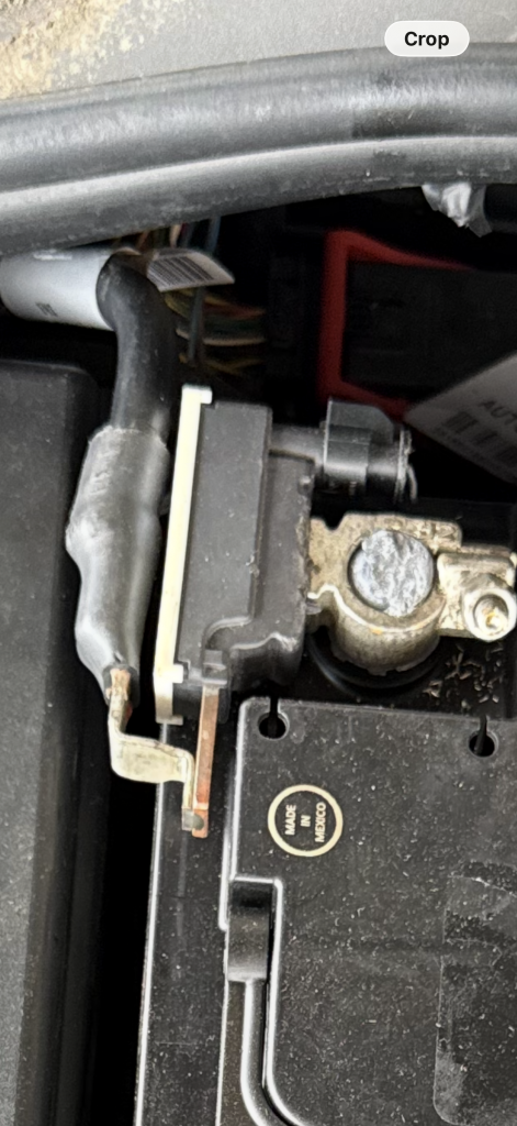

I recently had the same issue. Replaced the alternator and light stayed on. It was my negative battery terminal. There is a module on the top of it that went bad. I replaced it with a used one and no codes now

I'm curious about that part. There is a bare wire hanging off it and its connector with BMS written on it somewhere and I'm constantly handling it to disconnect the battery so I thought if I ever break it while handling it then I'll know what I need to buy lol. What is the specific Land Rover part number or part name for it?

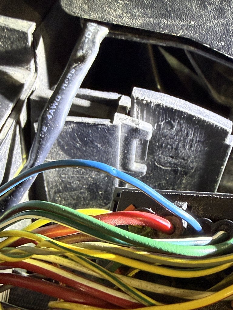

I also located a pinched wire from the harness to the alternator, did a temporary twist and after 30-sec from startup the charging system fault returned.
I then ran a temporary wire directly to the alternator to bypass the previous repair. Again, after 30-sec from start the charging system fault returned.
Any ideas based on the fault code P0A1A-87 (2F) ?
