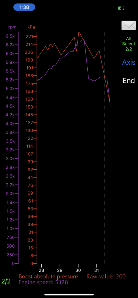

Question for those of you living at sea level and have done the pulley -- have any of you logged "boost pressure absolute - raw value" with the IID tool to see where it falls in the 3500-5000 range? I'm curious how much the tune + pulley makes up for me living at elevation.
I didn’t know you could do that! I may have to try this
