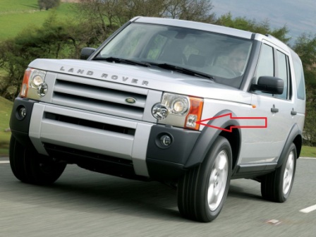

I need to replace the small light on the side of the headlamp assembly. I could only find one older post that was of not much help and nothing in the owners manual. Does anyone know what it needs? Thanks in advance.

194 for the two small blubs on the bottom right and 3457 for the blinker in the upper right.
I have the halogen so it was no an H8 for me.
