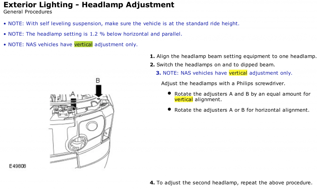

From the 2011 Workshop Manual -- "dipped beam" means low beam to us

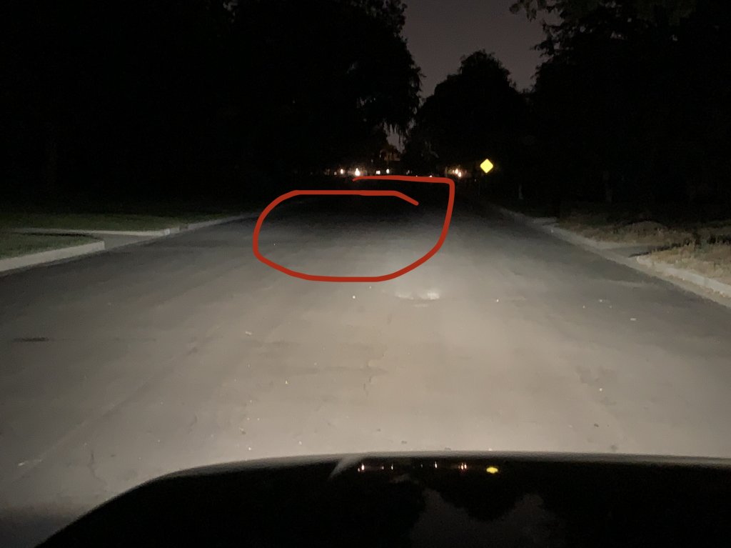

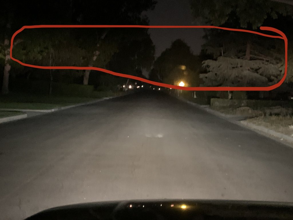

A question, did you notice that yes you can raise your low beam but when that’s in an acceptable position your high beam is basically shooting into the sky? I played with it again and the low beam DID move vertically ever so slightly. However, I noticed the high beam was now shooting into space looking for the Chinese rocket. I had to tell the car it had already landed in the Indian Ocean.
yup, do you think I should lower my high beam light or is this normal.

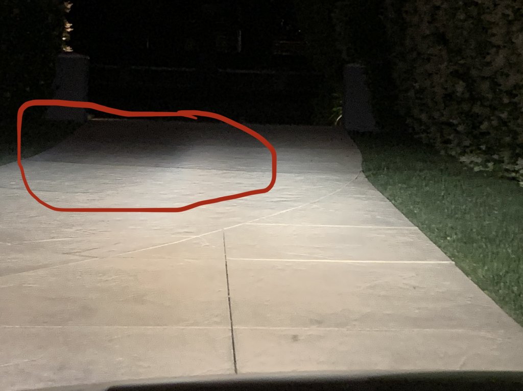

Mine was like this as well. On drive-on-the-right countries, the left (driver's) side headlight is often aimed slightly lower so as not to blind oncoming traffic.
alight just making sure because my car was in a fender bender early on in its life when a pick up truck decided to slide on ice right into the left head lamp of my car, so just making sure that it was all adjusted right. What do you think abt the High beams tho, are they slightly too high?

I have to be honest I never noticed this problem before because where I used to live there were plenty of street lights. And when I was off-road I was using high beams anyway. However where I am now it’s pitch black in many places on the street.
I can’t find a normal low beam position that doesn’t put the high beams shooting probably 20 feet in the sky at distance.
