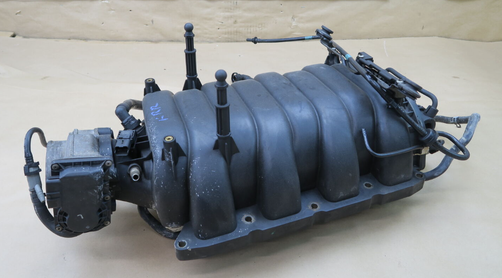

I don't buy the lost 5 qts being in the intake. How do they propose the 5 qts got into the intake? When I pulled my intake out there was some oil in there that dripped out, but maybe a tablespoon at most. The exhaust would smoke like a chimney having 5 quarts in there. It sounds like you drove it around w/out oil in it and there is some CYA.

I can't see where a large volume of oil would hide in the intake. A few spoonfuls sure but quarts? The oil would pool on the back side of the intake valves immediately I would think.

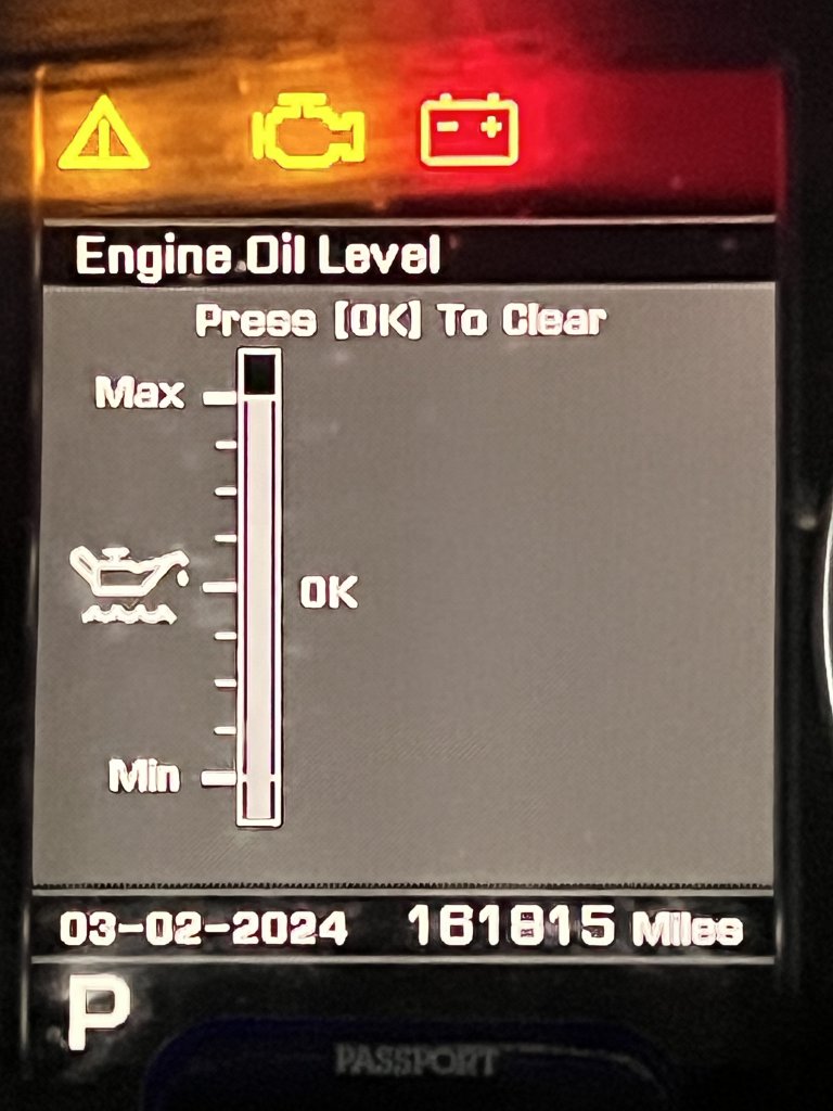

I really have no idea. I can say with certainty there hasnt been a drop on the floor as i have light grey epoxy that shows everything. As ive mentioned the dash oil indicator never showed more than asking for 1 qt. I have put 500 miles on it and i have this:

just realized i never updated this thread. the vacuum pump was replaced and no more smoke so far, compression and leak down tests both came back with no issues.
my tech thinks the broken vacuum pump was preventing the oil level monitor to read correctly, ie it never showed that the oil was very low, does that make sense?
The oil monitor did not work because of a tube that was separated in the oil pan. Even with the broken tube there was no notification or warning.
