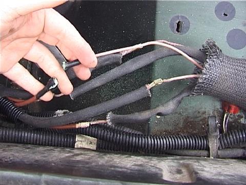

I have a 94 disco and my fusible links needs a replacement. Can I replace it with a regular inline fuses? Where can I get a replacement?

Yes you can replace with a standard fuse, but I would want to find out why it blew first.

Thanks Joey, any suggestions as to the fuse type and size? is it about 65 Amp?

I can't find the info on that fuse... got to love land rover manuals.
