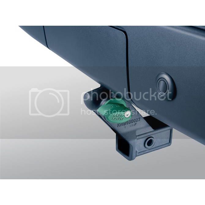

The key is black.
Couldn't get the link to work.
Looks like this one
jwest
Mar 22, 2008
2,041
409
Seattle WA
black key, oldest model.
side benefit of newest model is better location of mount point and pin. further back and higher/ less under and forward

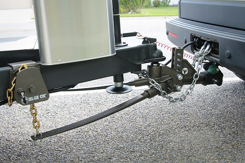

My husband called Can Am today and they basically told him towing with the LR3 would be fine. Just use "a WD system". For best value, they recommended the Eaz-Lift WD Hitch and mentioned they also sell Blue Ox and Husky. That was it, noting that doing the kind of hitch reinforcement they are accustomed to doing on smaller TV's was not likely to happen in our area. Plus, we wouldn't have anywhere to put the spare tire (that's just our observation).
We have the 3rd generation (newest) LR quick release hitch receiver on order.
Based on the information and other recommendations we've been able to collect from Can Am, the local LR dealership, the Florida LR dealership and Airstream forums (have found a few people there with LRs towing), it looks like we will need to use a WD system and anti-sway. So, right now we're narrowing it down to the Blue Ox Sway Pro.

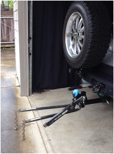

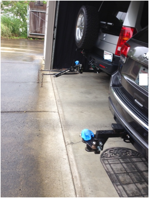

It will work
Here's my eaz lift set up, it was the set up I was already using. Sway bar is critical for the short wheel base. Just take your time except at the bottom of a hill, then get on the throttle if you can to keep your rpm up. My Super Duty and my Grand Cherokee Ecodiesel both heat up if I'm pushing them. I have a 25ft Forest River.
