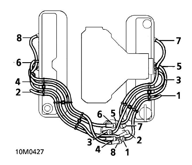

OK so we were changing the plugs and wires the other day and I had a little help, well all of the wires were taken off and I did not know where to put #1 So I put it to TDC on compression ******. Put number one there.. NO start, ok new cap and rotor.. Still not start, seems like the coil works wine but the spark at the plug seem eratic. Any help or suggestions would be apprecieated.
Oh I also sprayed starting fluid into intake manifold. no change, she does stumble every now and again but not very often, I have also tried moving the distributor, and it's not 180 out??
Thanks in advance.

Hope this helps

Joey. LOL that absolutely helped. We had number one on the other side.. Started right up, set her to -15 deg, Ready to go test her, Just wanted to stop and say thanks man.
