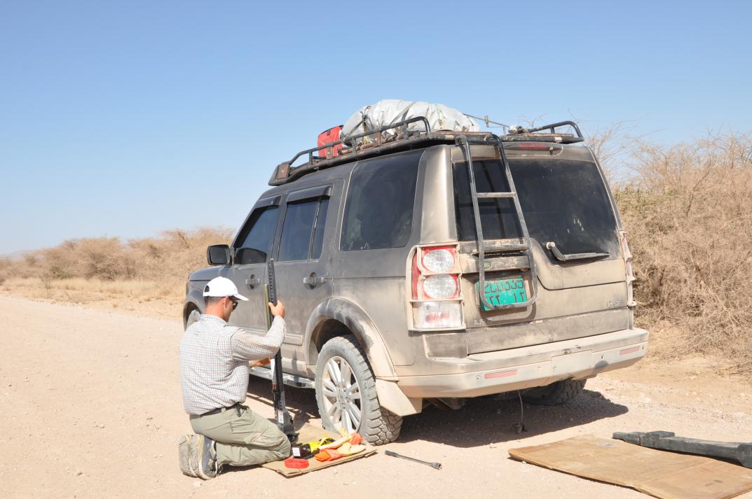

For me, the jackguard protects the jack from most dust and water and keeps the jack well-secured. I am including a picture of me using the jack on-piste one afternoon after shredding the rear-driver-side sidewall on a big/sharp rock (i.e. driving a bit too fast for that particular part of the piste). You can see the jackguard on the cardboard off to the right. Although I have the Hi-Lift wheel lift kit (Lift-Mate, L-100) out next to me, it won't work on the LR4 due to the variable suspension. Most of my equipment has been handy for helping others...not as much myself (I am generally a bit of a granny driver). So I carry everything I can in the event I need it for myself or someone else.

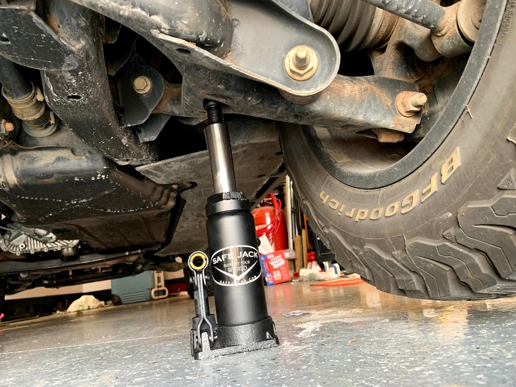

How big are your tires? 31.5" or 265/65R18 will clear the bump stops if you are all the way deflated.
The factory jack is super sketchy, but if you are going to use it, you will have to just jack on the lower control arm to lift the wheel off the ground. It has zero chance of lifting the body.. it will just droop the wheel and never go high enough. Opening the door just keeps it from leveling, but the suspension will still drop.
If you haven't taken a wheel off or lifted your truck to work on something then honestly please stay away from farm jacks and off road recovery...just for your own safety, go out with someone with experience and learn some things. You need suitable farm jack lift points to use one anyway, steel bumpers. Lifting on sliders can be pretty sketchy also.
My preference is a safe jack kit. Comes with all sorts of extensions and adapters to lift on frames or arms, etc. It may not be as cool as a farm jack but its safe and does everything I usually need to do for pulling tires off and such.

Access mode doesn’t really help much - as noted above, the tire will still drop if you raise from the frame, so access mode just makes it harder to work around the tire with no real benefit.
I just pull the fuse for the suspension (rather than leaving door open) and then jack it up by the frame with a long travel jack or under the control arm with a regular floor jack (which will put your wheel up much faster).
