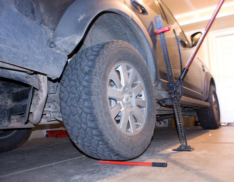

Looks like they are:
This is jacking up one corner using the step bumper on the sliders. I didn't see any flexing or complaining from the sliders while I did this.
I wanted to do another shot from the middle, trying to get the whole right side up, but after I took this shot I came to the uncomfortable realization that either my hi-jack is broken (came with a used Jeep I bought a few years ago), or I'm ******** and can't get it to reverse. Took a couple wooden blocks and some monkeying with a couple bottle jacks to get it down. I'll probably borrow a friend's hijack this week to see if I am ******** or what.
I can't offer you any comfortable advice about your mental acumen, however, I seriously doubt your HiLift is broken, and I doubt you were doing it wrong. HiLift's need periodic maintainence, and if seldom used, need a good working over to "wear them in" properly.
http://www.jpmagazine.com/techarticles/154_0808_10_ways_to_get_your_jack_working/index.html

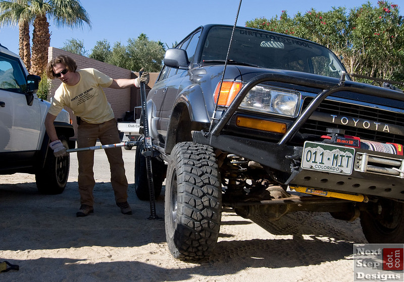

Also, while ******* a concrete floor, if you are doing this in the dirt, push the base inward under the truck a bit, so that the jack is leaning away from your door panel more. Good idea on using the urethane handle holder as a bumper, but...
Here is an example of leaning the jack away from the bodywork:
