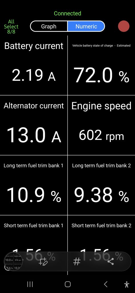

Let me give it a try. I have gap iid on my phone, so will need to grab the wife's phone to record. I do have a screenshot of when put a load on at idle.

Closing this thread.
I took the car to a reputable indy land rover shop and was told this is normal. There is nothing wrong. Revs can drop, car can shake, nothing to worry about. I'll continue to keep an eye on it, but going to move on from it.
Thanks for all the input.
