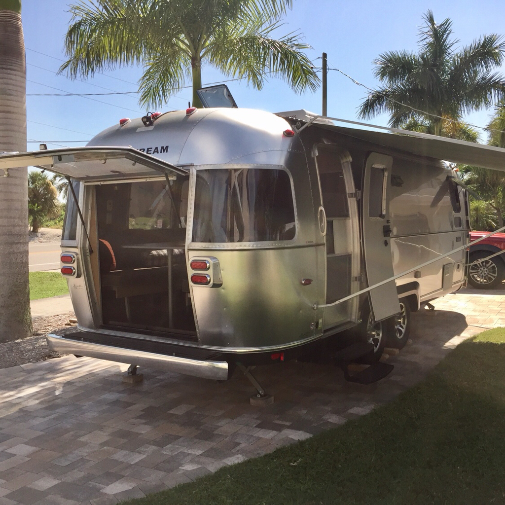

LR3 has been sold outside of regular maintenance items. She’s been well cared for!
You're selling your '08 LR3, not your '13 Barossa LR4, right?
Either way, that is a great looking rig. Do you find that you get regular use out of the hatch rear opening? #ballerairstream

Hey
Selling LR3, Barrossa gone about 2+ yeas ago.
Use it all the time, I specifically wanted the hatch and luckily found a nice ‘13 Eddie Bauer last year.
