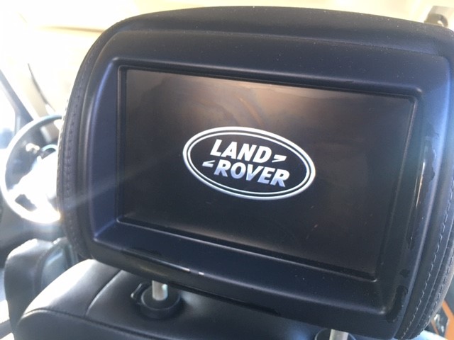

Hey guys. Just joined the LR community with a 2013 LR4. The previous owner had young children and the interior needs a bit of a spruce up. Can't find much through google on these issues so looking for guidance on here. I've attached a picture of each below as well. As it stands the issues I need to address at hand are:
  1. AC vents for the second row on the center console are in rough shape with one missing the directional fins completely. I've already purchased two replacements but I hope these just pop on and off?

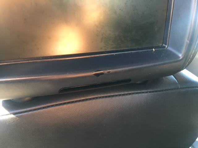

  2. The trim on the rear TV screens is peeling and is just unsightly. Any recommendations on how to tackle this? Plastic touchup kits etc or what?

i dont think there is a solution for the tv bezels. either DIY refinish, or replace.

P.D. about the screen trim, if is cosmetic, just let it as it seen. It will take too much time and money for something who don't really care (screen is working).
