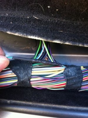

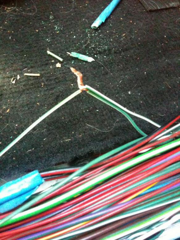

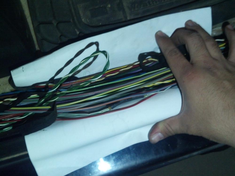

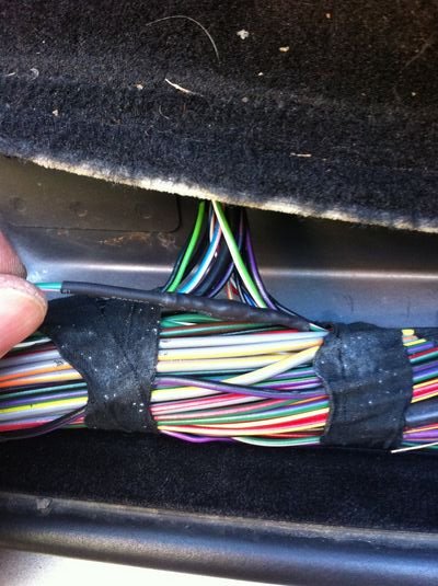

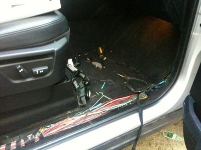

Good day. The post is intended to sum up my experience with a leak in my LR3, resulting in soaking wet floor mats and my key fobs / keyless entry suddenly not working. There are great posts out there but all over the place with most of the pics not working. So with great thanks to all previous authors, I’d like to sum up.
1. We had heavy rainfall for days and somehow there was water coming into the cabin of the rover. This post will not cover the leak or if the water came through the sunroof or the window seal. I will talk about the key fobs not working only.
2. Right after assessing the water problem I noted that neither of my two key fobs wouldn’t work.
3. After long research I opened the passenger (right) side cable channel in the floor next to the passenger door. It took a while to get all these stiff plastic pieces out, but you will be able to do it.
4. I also opened the driver side (left) and dried all the cable in there. There is not splice with a green/white cable. Don’t waste your time looking in there.
5. In there you will find an about 1 inch thick cable. Mine was soaked. You have to peal of the black electric tape to free the entire bunch. Right after I took all these cables in my hand I noticed the famous green/white cable splice that came apart in the water.
6. Fix it as you can see fit. The key fob/keyless entry will work right away.
Let me know if you have any questions.
