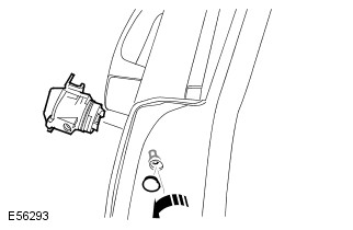

Pop the cover off the driver door handle to reveal the key slot.
Open the driver's door. Inside the rear part of door, at the outside door handle level. Pop the little round cap off. Allows access to door lock tumbler.
Take a T25 Torx, remove the bolt. NOT all the way out.
Slide the lock cylinder assembly out and inspect the inner plastic pieces for damage.
