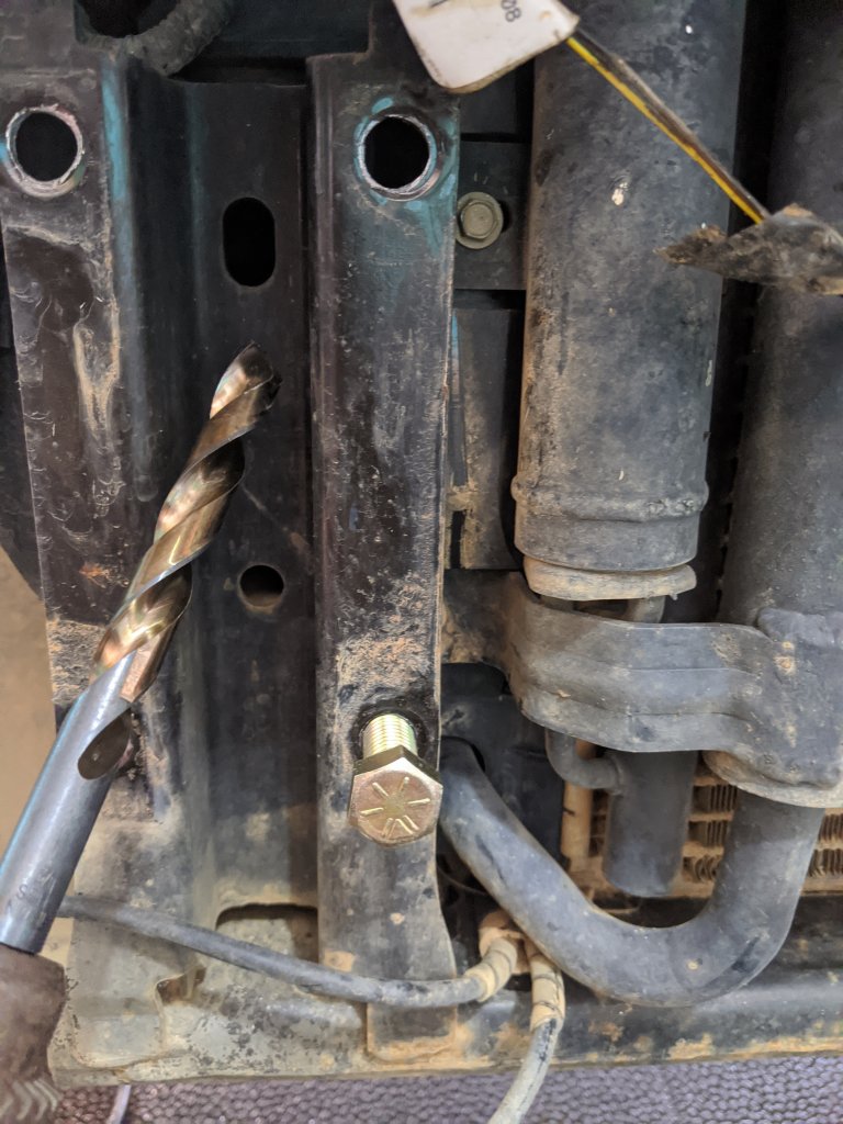

I just drilled them out...they pop off eventually

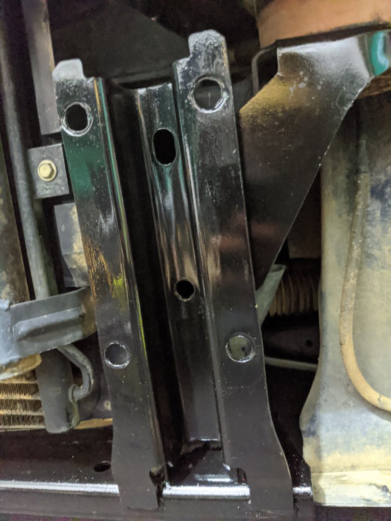

Once I drilled all 8 out, I sanded everything down and applied a few coats of POR15 on it prior to mounting the winch plate. Figured might as well to give it max protection...and @avslash , that will be the easiest part of this..finding grade 8 washers that fit behind there was tough for me locally... Tightening the lock nuts is really tough... Tight fit:

@iSurfvilano
What size bit did you use? Looks like 3/8 maybe?
I used 1/2" bolts so used a 1/2" bit, but it may be wise to go smaller first to get that weld out...I didn't though. Be sure you have a steady hand, the drill is going to want to pull to the right and that poses a risk of widening the hole. It worked out perfectly for me but I was worried that I would have to keep adjusting the holes to get the plate to fit.

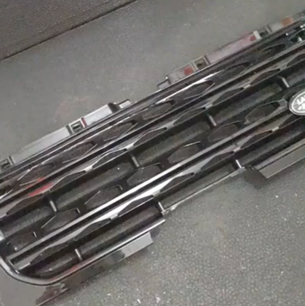

Any pics of how you had to trim the grill?
This is the only pic I have at the moment but can take more when I get home. Cutting it like this will get the tightest fit...I could've trimmed more to make installation/removal easier... But this is the minimum.
